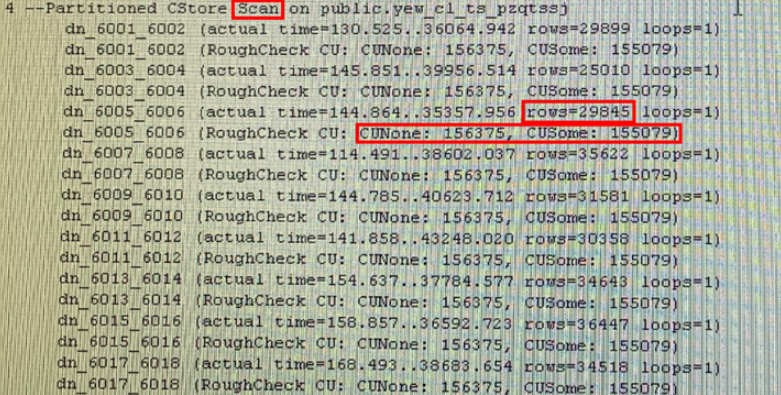

Scenario 1: Small CU Bloat in Column Storage

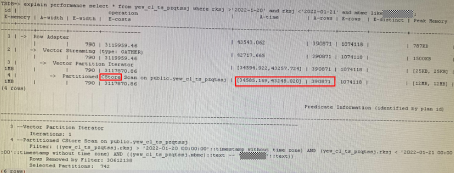

A SQL statement takes 43248 ms to query 390871 pieces of data. After analysis, it is found that most time is consumed by Cstore Scan.
In the Cstore Scan details, about 20,000 data records are scanned on each DN. 155079 CUs (CUSome) with data are scanned, and 156375 CUs (CUNone) without data are scanned. This means that CUs are bloated with many small CUs and unmatched CUs.
Trigger condition: High-frequency small-batch import to column-store tables (especially partitioned tables) causes CU bloat.

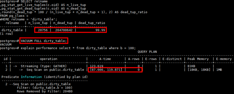

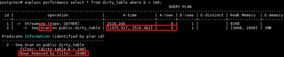

Scenario 2: Dirty Data Cleanup
A SQL statement takes 2.519 seconds to execute, with 2.516 seconds spent on scanning. However, none of the 20,480 scanned records match the conditions and are all filtered out. The scanning time is too long considering the amount of data scanned, indicating that the scanning and I/O efficiency are significantly reduced due to a large amount of dirty data.
The dirty page rate of the table is 99%. After the VACUUM FULL operation is performed, the performance is optimized to about 100 ms.
Trigger condition: Frequent UPDATE or DELETE operations of tables and lack of timely VACUUM FULL operations lead to a large amount of dirty data.
Solution
  1. To address this issue, it is recommended to periodically perform VACUUM FULL on tables that are frequently updated or deleted to remove dirty data. Since VACUUM FULL is I/O-intensive for large tables, it should be scheduled during off-peak hours to avoid increasing I/O pressure during peak hours.
  2. If dirty data accumulates rapidly, excessive VACUUM FULL operations can consume a significant number of I/Os and worsen the overall I/O bottleneck of the system. In such cases, it is important to investigate and identify the source of the dirty data. For scenarios where data is frequently deleted, the following solutions can be used:
    1. Use TRUNCATE instead of DELETE and use temporary tables.
    2. Regularly perform DELETE operation on data generated in a specified period. Use partition tables and use TRUNCATE or DROP (partitions) instead.

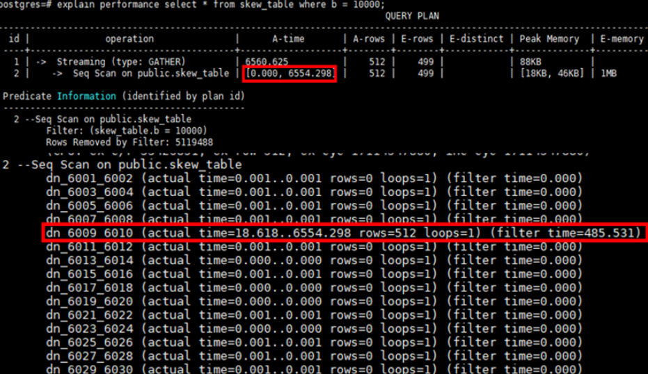

Scenario 3: Table Storage Skew
For instance, during a table scan, the maximum A-time of a DN is 6554 ms, and the minimum A-time of a DN is 0s. The DNs' scan time difference is over 10 times. This indicates that the problem is due to table storage skew.

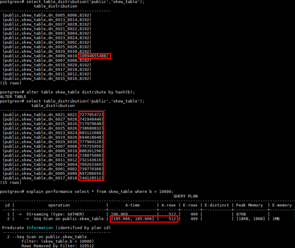

Run the table_distribution command. It is found that all data is skewed to dn_6009. After the distribution column is modified to evenly distribute the table storage, the maximum DN A-time and the minimum DN A-time remain at the same level (about 400 ms), and the scan time is reduced from 6554 ms to 431 ms.
Trigger condition: Improper selection of the distribution column during data distribution can lead to storage skew and unbalanced pressure between DNs. This results in high I/O pressure on a single DN and overall decreased I/O efficiency.
Solution: Modify the distribution key of the table to ensure even distribution. For how to select a distribution key, see Selecting a Distribution Key.

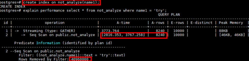

Scenario 4: No Indexes or Indexes Are Not Used
The Seq Scan for a point query takes 3767 ms. It scans 4096000 records to find 8240 matches. This is suitable for Index Scan. However, even after adding indexes to the filter column, the plan stills use Seq Scan instead of Index Scan.

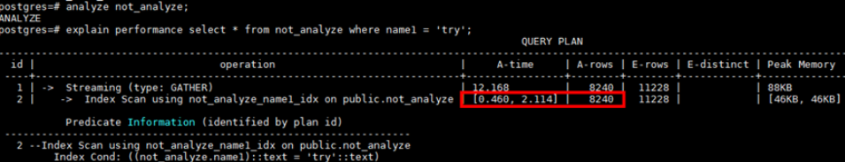

By analyzing the target table, the plan can automatically select indexes, optimizing performance from 3 seconds+ to 2 milliseconds+, significantly reducing I/O consumption.

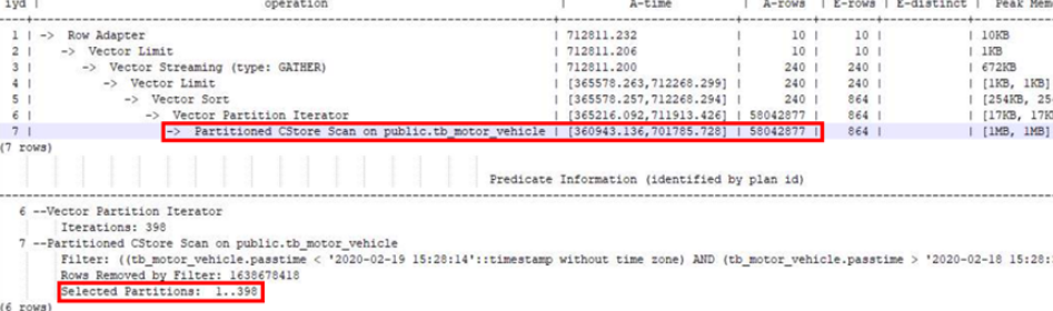

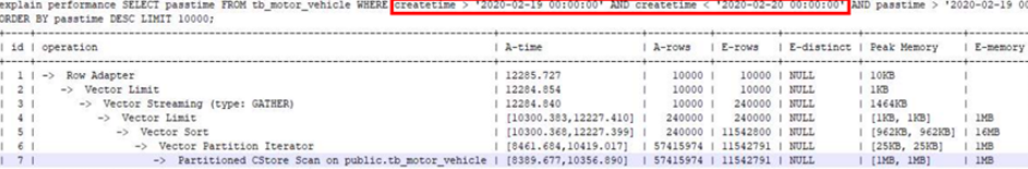

Scenario 5: No Partition or No Pruning for Partitions
For example, when filtering a service table by the createtime column to retrieve data at a specific time, the table is partitioned. However, if partition pruning is not performed due to a large number of selected partitions, the scan takes 701,785 milliseconds, resulting in poor I/O efficiency.
By adding the partition key createtime as a filter, partition pruning is enabled during the partitioned scan (given that the number of selected partitions is small). This improves performance from 700 seconds to 10 seconds, significantly boosting the I/O efficiency.
Common scenarios: For large tables that are time-based, most queries only access data for today or a few days. To improve I/O efficiency, partition pruning should be performed by scanning only the relevant partitions based on the partition keys. However, there are certain cases where partition pruning does not occur.

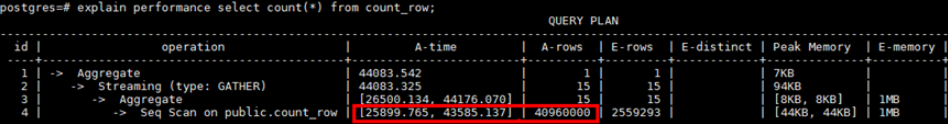

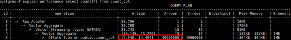

Scenario 6: Calculating the Count Value in a Row-Store Table
For example, in a row-store large table, counting the entire table without any filters or with filters that only apply to a small amount of data is a typical scenario. This scanning process takes 43 seconds and consumes a significant amount of I/O resources. When multiple count jobs are executed concurrently in the system, the system's I/O remains at 100%, resulting in an I/O bottleneck and decreased performance.
Compared to column-store tables with the same data volume (A-rows is 40960000), scanning column-store tables only takes 14 milliseconds and has very low I/O usage.
Possible cause: The storage mode of row-store tables makes full table scans inefficient, resulting in constant I/O usage when scanning large tables.
Solution:
  • Perform only necessary table counts and lower the concurrency of count jobs.
  • Use column-store tables to improve the I/O efficiency.

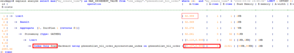

Scenario 7: Calculating the Max Value in a Row-Store Table
For example, retrieving the maximum value of a column in a row-store table takes 26,772 milliseconds. When such tasks are executed concurrently, the system's I/O remains at 100%, causing an I/O bottleneck and decreased performance.
However, after adding an index to the max column, the execution time of the statement is reduced from 26 seconds to 32 milliseconds, significantly reducing I/O consumption.
Possible cause: To find the maximum value in a row-store table, each value is scanned. Scanning a lot of data consumes the I/O constantly.
Solution: Index the max column with a B-tree index. It sorts the values to speed up the scan and lower the I/O usage.

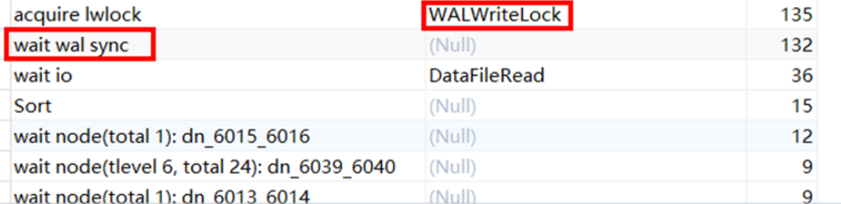

Scenario 8: Importing a Large Amount of Data with Indexes
Customer data sync to DWS takes a long time and stresses the cluster's I/O.
The waiting view shows many wait wal sync and WALWriteLock states, meaning xlog sync is ongoing.
Possible cause: Importing a significant amount of data (through insert/copy/merge operations) along with multiple indexes leads to the generation of numerous Xlogs. This, in turn, causes a slowdown in the synchronization process between the active and standby nodes, resulting in the standby node being in the Catchup state for an extended period and a spike in I/O usage.

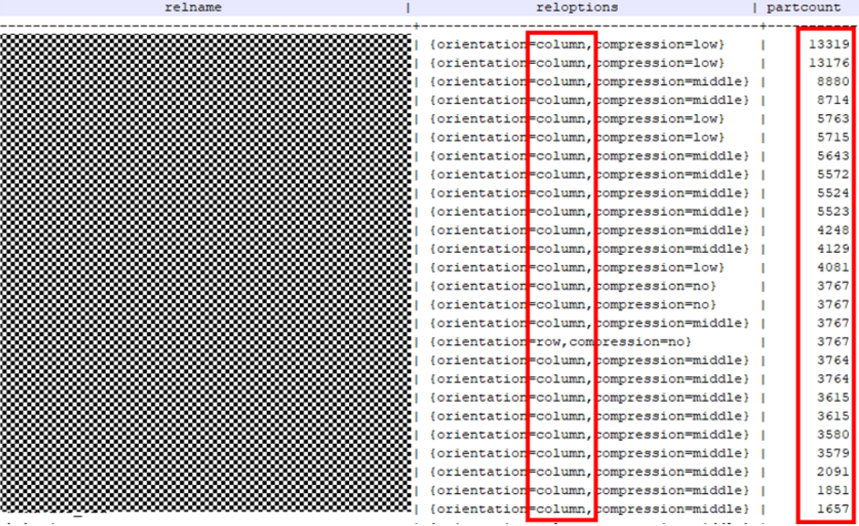

Scenario 10: Multiple Small Files and High IOPS
During the execution of a service, the IOPS of the entire cluster increases sharply. When the cluster faults, the rebuilding stalls, and the IOPS surges. Here is the table info:
SELECT relname,reloptions,partcount FROM pg_class c INNER JOIN ( SELECT parentid,count(*) AS partcount FROM pg_partition GROUP BY parentid ) s ON c.oid = s.parentid ORDER BY partcount DESC;
Possible cause: A service database has many column-store multi-partition tables (over 3000). This creates many small files (over 20 million files per DN), lowers the access efficiency, and slows down the cluster rebuilding. Also, rebuilding consumes many IOPS, hurting the service performance.
