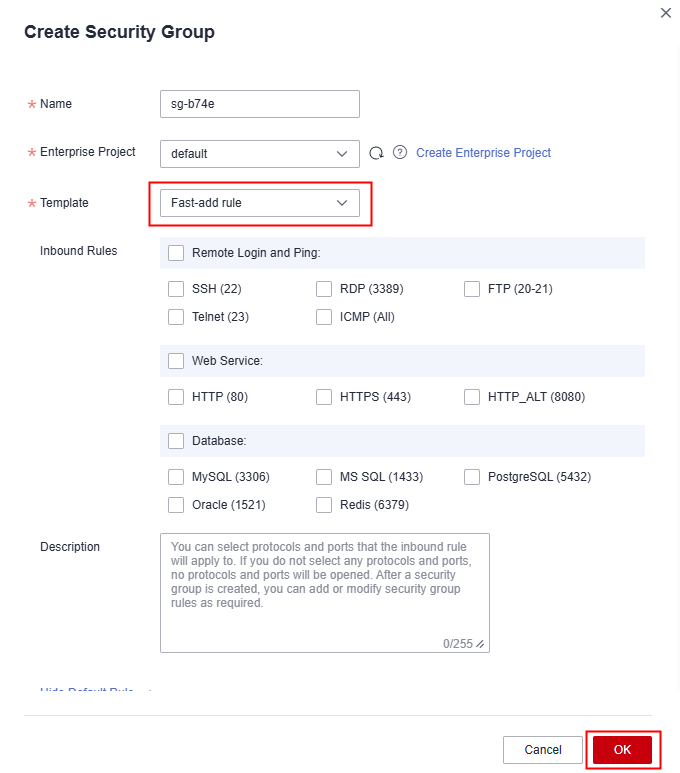

- Log in to Network Console and choose Access Control > Security Groups.
- Click Create Security Group in the upper right corner to create a security group that does not allow traffic through any port. See Figure 1.

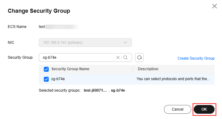

- Switch to Cloud Server Console and add the server you want to restore to the security group you created in Step 2.
Click the server name. On the Security Groups tab page, click Change Security Group. See #cbr_05_0012/fig10411110153713.
Figure 2 Changing a security group

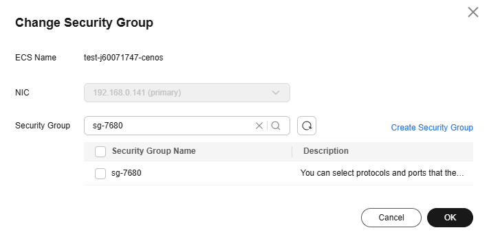

- Change the security group of the destination server as follows:
In the outbound direction of the security group, configure ports 1 to 65535 on the 100.125.0.0/16 network segment. In the inbound direction, configure ports 59526 to 59528 on the 100.125.0.0/16 network segment.
For details on how to change a security group, see Changing a Security Group. See Figure 5.
