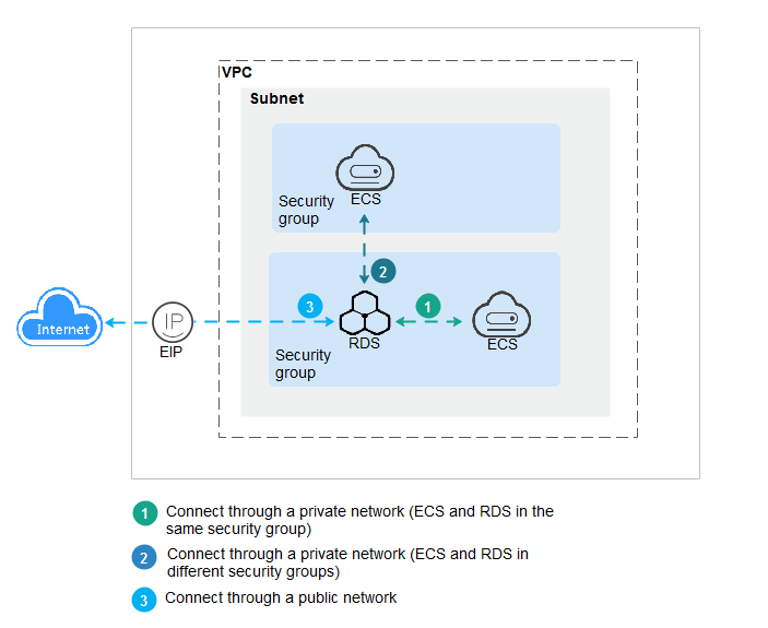

Figure 1 illustrates the connection over a private network or a public network.
Figure 1 DB instance connection
