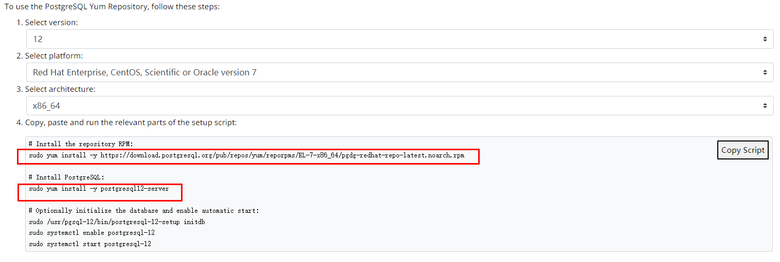

  5. Install a PostgreSQL client.
    The PostgreSQL community provides client installation methods for different OSs. You can download and install a client using the installation tool of the OS. This installation method is simple but can be used only for the OSs supported by the PostgreSQL community.
    In this example, CentOS 7 is used. Use the default installation tool of the OS to install a client (PostgreSQL 15 or earlier).
    Figure 1 Obtaining the installation tool

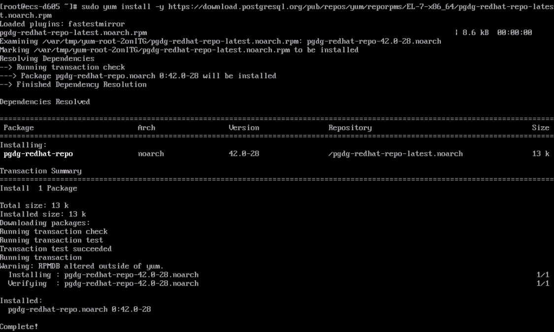

    Run the installation commands:
    sudo yum install -y https://download.postgresql.org/pub/repos/yum/reporpms/EL-7-x86_64/pgdg-redhat-repo-latest.noarch.rpm

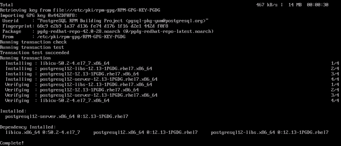

    sudo yum install -y postgresql15-server
    Check whether the installation is successful.
    psql -V
    Figure 2 Successful installation
