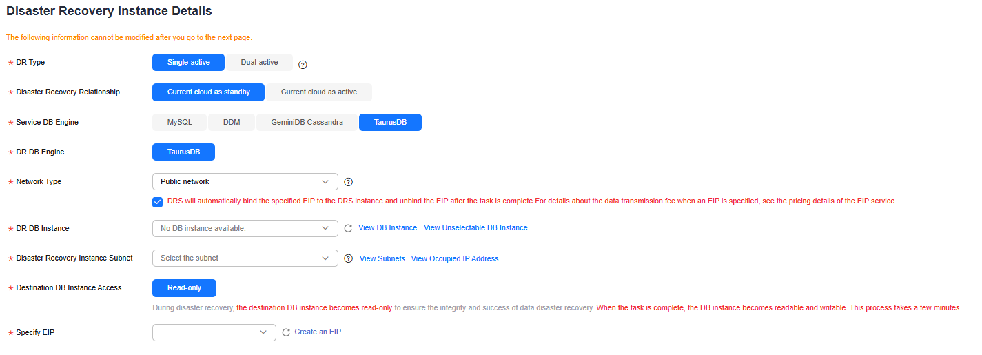

    DR Type
    Select Single-active.
    The DR type can be single-active or dual-active. If Dual-active is selected, two subtasks are created by default, a forward DR task and a backward DR task.
    NOTE:
    Only whitelisted users can use dual-active DR. To use this function, submit a service ticket. In the upper right corner of the management console, choose Service Tickets > Create Service Ticket to submit a service ticket.
    Disaster Recovery Relationship
    Select Current cloud as standby. This parameter is available only when you select Single-active.
    By default, Current cloud as standby is selected. You can also select Current cloud as active.
    • Current cloud as standby: The DR database is on the current cloud.
    • Current cloud as active: The service database is on the current cloud.
    Service DB Engine
    Select GaussDB(for MySQL) Primary/Standby Edition.
    DR DB Engine
    Network Type
    The public network is used as an example.
    Available options: VPN or Direct Connect and Public network. By default, the value is Public network.
    DR DB Instance
    The GaussDB(for MySQL) primary/standby instance you created.
    Disaster Recovery Instance Subnet
    Select the subnet where the disaster recovery instance is located. You can also click View Subnet to go to the network console to view the subnet where the instance resides.
    By default, the DRS instance and the destination DB instance are in the same subnet. You need to select the subnet where the DRS instance resides and ensure that there are available IP addresses. To ensure that the disaster recovery instance is successfully created, only subnets with DHCP enabled are displayed.
    Destination Database Access
    Select Read-only. This parameter is available only when you select Single-active.
    During single-active disaster recovery, the DR database becomes read-only. To change the DR database to Read/Write, you can change the DR database (or destination database) to a service database by clicking Promote Current Cloud on the Disaster Recovery Monitoring tab. After the DR task is complete or deleted, you can query and read data to the DR database.
    When the external database functions as the DR database, the user with the superuser permission can set the database to read-only.
    If a DRS instance node is rebuilt due to a fault, to ensure data consistency during the DRS task restoration, the current cloud standby database is set to read-only before the task is restored. After the task is restored, the synchronization relationship recovers.

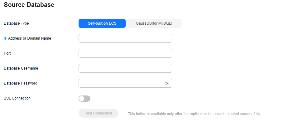

      Source Database Type
      By default, Self-built on ECS is selected.
      The source database can be a Self-built on ECS or an RDS DB instance. After selecting RDS DB instance, select the region where the source database resides and the region cannot be the same as the region where the destination database resides. The region where the destination database is located is the region where you log in to the management console. To use the RDS DB instance option, submit a service ticket.
      IP Address or Domain Name
      The IP address or domain name of the service database.
      Port
      The port of the service database. Range: 1 – 65535
      Database Username
      The username for accessing the service database.
      Database Password
      The password for the service database username. You can change the password if necessary. To change the password, perform the following operation after the task is created:
      If the task is in the Starting, Initializing, Disaster recovery in progress, or Disaster recovery failed status, in the DR Information area on the Basic Information tab, click Modify Connection Details. In the displayed dialog box, change the password.
      SSL Connection
      SSL encrypts the connections between the source and destination databases. If SSL is enabled, upload the SSL CA root certificate.
      NOTE:
      • The maximum size of a single certificate file that can be uploaded is 500 KB.
      • If the SSL certificate is not used, your data may be at risk.

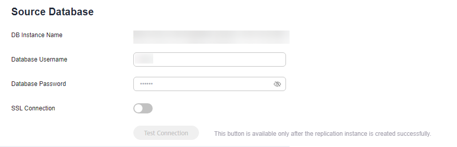

      DB Instance Name
      The name of the service DB instance. This parameter is available only when the source database is an RDS DB instance.
      Database Username
      Database Password
      NOTE:
      The IP address, domain name, username, and password of the service database are encrypted and stored in DRS and will be cleared after the task is deleted.

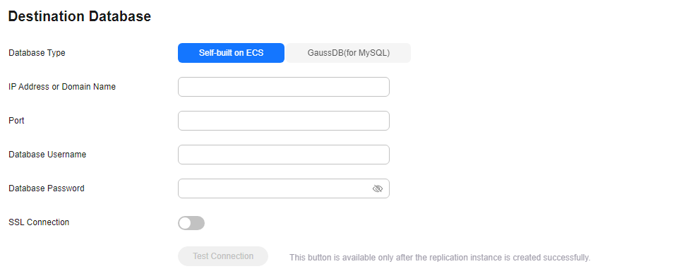

      Database Type
      The destination database can be a Self-built on ECS or an RDS DB instance. If you select RDS DB instance, you need to select the region where the destination database is located.
      The IP address or domain name of the DR database.
      Port
      The port of the DR database. Range: 1 – 65535
      Database Username
      The username for accessing the DR database.
      Database Password
      The password for the DR database username. You can change the password if necessary. To change the password, perform the following operation after the task is created:

      SSL Connection
      NOTE:
      Region
      Region where the GaussDB (for MySQL) primary/standby instance is located. This parameter is available only when the source database is an RDS DB instance.
      DB Instance Name
      DR instance name. This parameter is available only when the source database is an RDS DB instance.
      NOTE:
      When the DB instance is used as the DR database, it is set to read-only. After the task is complete, the DB instance can be readable and writable.
      Database Username
      Username for logging in to the DR database.
      Database Password
      Password for the database username.
      NOTE:
      The IP address, domain name, username, and password of the DR database are encrypted and stored in DRS and will be cleared after the task is deleted.
