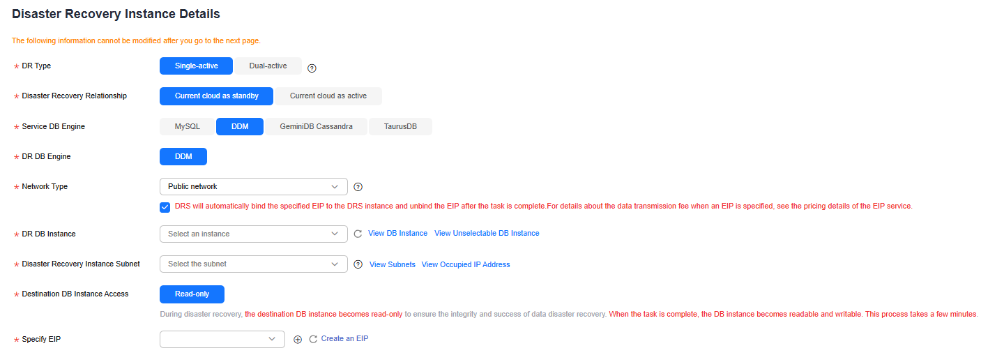

- DR instance information
Figure 1 DR instance information
Table 5 DR instance settings Parameter
Description
DR Type
Select Single-active.
The DR type can be single-active or dual-active. If Dual-active is selected, two subtasks are created by default, a forward DR task and a backward DR task.
NOTE:Only whitelisted users can use dual-active DR. To use this function, submit a service ticket. In the upper right corner of the management console, choose Service Tickets > Create Service Ticket to submit a service ticket.
Disaster Recovery Relationship
Select Current cloud as standby. This parameter is available only when you select Single-active.
By default, Current cloud as standby is selected. You can also select Current cloud as active.
- Current cloud as standby: The DR database is on the current cloud.
- Current cloud as active: The service database is on the current cloud.
Service DB Engine
Select DDM.
DR DB Engine
Select DDM.
Network Type
The public network is used as an example.
Available options: VPN or Direct Connect and Public network. By default, the value is Public network.
DR DB Instance
The DDM instance you created.
Disaster Recovery Instance Subnet
Select the subnet where the disaster recovery instance is located. You can also click View Subnets to go to the network console to view the subnet where the instance resides.
By default, the DRS instance and the DR DB instance are in the same subnet. You need to select the subnet where the DRS instance resides and ensure that there are available IP addresses. To ensure that the disaster recovery instance is successfully created, only subnets with DHCP enabled are displayed.
Destination DB Instance Access
Select Read-only. This parameter is available only when you select Single-active.
- During disaster recovery, the entire DR database instance becomes read-only. To change the DR database to Read/Write, you can change the DR database (or destination database) to a service database by clicking Batch Operation > Primary/Standby Switchover on the Disaster Recovery Management page.
- If a DR task fails, the DR database automatically changes to the read/write state.
- After the DR task is complete, the DR database changes to Read/Write.
- When the external database functions as the DR database, the user with the superuser permission can set the database to read-only.
- If a DRS instance node is rebuilt due to a fault, to ensure data consistency during the DRS task restoration, the current cloud standby database is set to read-only before the task is restored. After the task is restored, the synchronization relationship recovers.
Specify EIP
This parameter is available when you select Public network for Network Type. Select an EIP to be bound to the DRS instance. DRS will automatically bind the specified EIP to the DRS instance and unbind the EIP after the task is complete. The number of specified EIPs must be the consistent with that of DB instances.

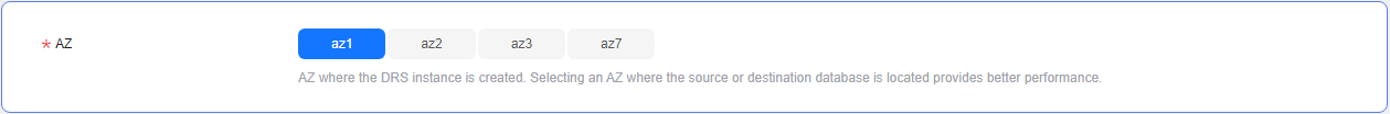

- AZ
Figure 2 AZ
Table 6 Task AZ Parameter
Description
AZ
Select the AZ where you want to create the DRS task. Selecting the one housing the source or destination database can provide better performance.

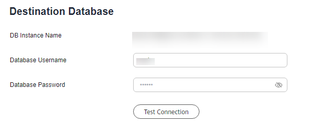

Figure 3 DR database information
Table 9 DR database settings Parameter
Description
DB Instance Name
The DDM instance you selected when you create the DR task. The instance name cannot be changed.
Database Username
The username for accessing the DR database.
Database Password
The password for the database username. You can change the password if necessary. To change the password, perform the following operation after the task is created:
If the task is in the Starting, Initializing, Disaster recovery in progress, or Disaster recovery failed status, in the DR Information area on the Basic Information tab, click Modify Connection Details. In the displayed dialog box, change the password.
The database username and password are encrypted and stored in the system, and will be cleared after the task is deleted.

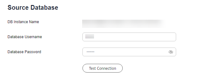

- Select Current cloud as active for Disaster Recovery Relationship in 2.
Figure 4 Service database information
Table 10 Service database settings Parameter
Description
DB Instance Name
Database Username
The username for accessing the service database.
Database Password

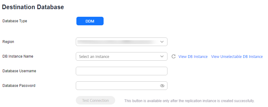

Figure 5 DR database information
Table 11 DR database settings Parameter
Description
Database Type
Type of the DR database.
Region
The region where the DDM instance is located.
DB Instance Name
Name of the DR instance.
NOTE:When the DB instance is used as the DR database, it is set to read-only. After the task is complete, the DB instance can be readable and writable.
Database Username
Username for logging in to the DR database.
Database Password
Password for the database username.
The username and password of the DR databases are encrypted and stored in DRS, and will be cleared after the task is deleted.

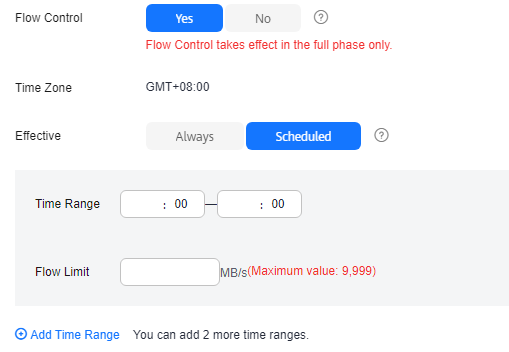

- On the Configure DR page, specify flow control and click Next.
Table 12 DR settings Parameter
Description
Flow Control
You can choose whether to control the flow.
- Yes
You can customize the maximum disaster recovery speed. During the disaster recovery, the speed of each task (or each subtask in multi-task mode) does not exceed the value of this parameter.
In addition, you can set the time range based on your service requirements. The traffic rate setting usually includes setting of a rate limiting time period and a traffic rate value. Flow can be controlled all day or during specific time ranges. The default value is Always. A maximum of 10 time ranges can be set, and they cannot overlap.
The flow rate must be set based on the service scenario and cannot exceed 9,999 MB/s.
Figure 6 Flow control
- No
The DR speed is not limited and the outbound bandwidth of the source database is maximally used, which causes read consumption on the source database accordingly. For example, if the outbound bandwidth of the source database is 100 MB/s and 80% bandwidth is used, the I/O consumption on the source database is 80 MB/s.NOTE:
- Flow control mode takes effect only in the DR initialization phase.
- You can also change the flow control mode when the task is in the Configuration state. For details, see Modifying the Flow Control Mode.

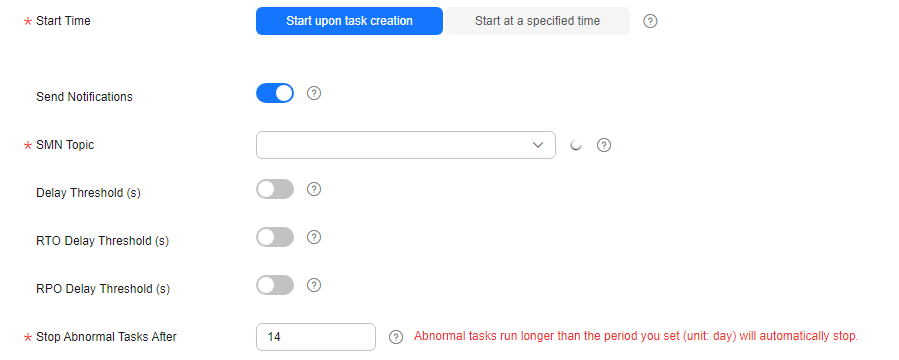

- On the Confirm Task page, specify Start Time, Send Notifications, SMN Topic, Delay Threshold, RPO Delay Threshold, RTO Delay Threshold, Stop Abnormal Tasks After. After confirming that the configured information about the DR task is correct, click Submit.
Figure 7 Task startup settings
Table 13 Task settings Parameter
Description
Start Time
Set Start Time to Start upon task creation or Start at a specified time based on site requirements.
NOTE:Starting a DR task may slightly affect the performance of the service and DR databases. You are advised to start a DR task during off-peak hours.
Send Notifications
This parameter is optional. After enabled, select a SMN topic. If the status or latency metric of the DR task is abnormal, DRS will send you a notification.
SMN Topic
This parameter is available only after you enable Send Notifications and create a topic on the SMN console and add a subscriber.
For details, see Simple Message Notification User Guide.
Delay Threshold (s)
During disaster recovery, a synchronization delay indicates a time difference (in seconds) of synchronization between the service and DR database.
If the synchronization delay exceeds the threshold you specify, DRS will send alarms to the specified recipients. The value ranges from 0 to 3,600. To avoid repeated alarms caused by the fluctuation of delay, an alarm is sent only after the delay has exceeded the threshold for six minutes.
NOTE:- Before setting the delay threshold, enable Send Notifications.
- If the delay threshold is set to 0, no notifications will be sent to the recipient.
RTO Delay Threshold (s)
If the synchronization delay from the DRS instance to the DR database exceeds the threshold you specify, DRS will notify specified recipients. The value ranges from 0 to 3,600. To avoid repeated alarms caused by the fluctuation of delay, an alarm is sent only after the delay has exceeded the threshold for six minutes.
NOTE:- Before setting the RTO delay threshold, enable Send Notifications.
RPO Delay Threshold (s)
If the synchronization delay from the DRS instance to the service database exceeds the threshold you specify, DRS will notify specified recipients. The value ranges from 0 to 3,600. To avoid repeated alarms caused by the fluctuation of delay, an alarm is sent only after the delay has exceeded the threshold for six minutes.
- In the early stages of an incremental DR, more delay is normal because more data is waiting to be synchronized. In this situation, no notifications will be sent.
Number of days after which an abnormal task is automatically stopped. The value must range from 14 to 100. The default value is 14.
NOTE:- You can set this parameter only for pay-per-use tasks.
- Tasks in the abnormal state are still charged. If tasks remain in the abnormal state for a long time, they cannot be resumed. Any task in the abnormal state that has run for longer than the period you set here (in days) will automatically stop to avoid unnecessary fees.
- After the task is submitted, view and manage it on the Disaster Recovery Management page.
- You can view the task status. For more information about task status, see Task Statuses.
- You can click
in the upper-right corner to view the latest task status. - By default, DRS retains a task in the Configuration state for three days. After three days, DRS automatically deletes background resources, but the task status remains unchanged. When you reconfigure the task, DRS applies for resources again.
- For a public network task, DRS needs to delete background resources after you stop the task. The EIP bound to the task cannot be restored to the Unbound state until background resources are deleted.
- For a task that is in the Disaster recovery in progress state, you can use data comparison to check whether data is consistent before and after the disaster recovery.
