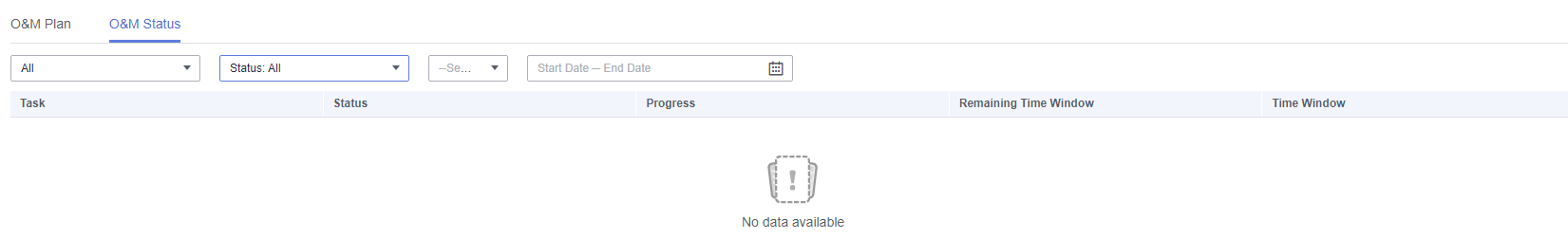

Viewing O&M Tasks
  1. Log in to the DWS console.
  2. Click the name of the target cluster.
  3. In the navigation pane, choose Intelligent O&M.
  4. Switch to the O&M Status area.
  5. Check that the following tables are sorted in descending order based on the size of released space: tables being vacuumed, tables to be vacuumed, tables that have been vacuumed, and tables that failed to be vacuumed. A maximum of 100 tables can be displayed on each page.
