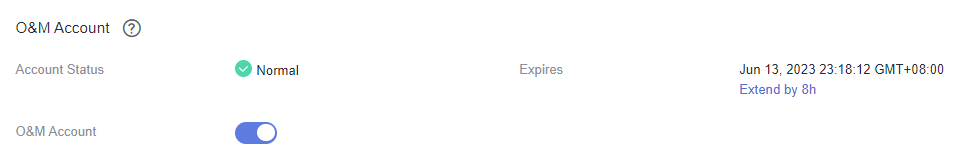

- On the cluster details page, and enable O&M Account in the O&M Account area. Figure 2 Enabling O&M Account
- In the displayed dialog box, click OK.
- Check the created O&M account. Its name format is om_user_First eight numbers in the cluster ID.

- On the cluster details page, click Extend by 8h in the O&M Account area.
- For a normal account, its validity period is extended to 8 hours later than its expiration time.
- For an expired account, its validity period is extended to 8 hours later than the current time.
