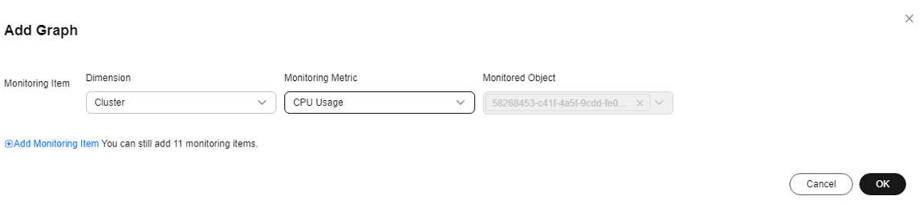

- Choose Monitoring > Performance > Monitoring View. On the displayed page, choose an instance to see its memory usage rate. Verify the information and click OK. Figure 1 Adding a monitoring view for instance memory usage

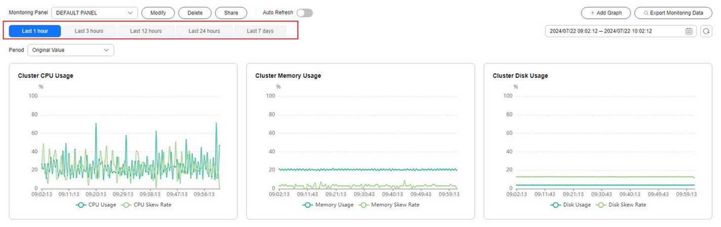

- You can view the memory usage of each instance in the current cluster at the page's bottom. In the upper left corner, you can check the memory usage of each instance in the last 1, 3, 12, 24 hours, or 7 days. This helps you detect any sudden increase in memory usage of any instance. Figure 2 Instance memory usage monitoring view
- If the memory usage of an instance frequently increases and then returns to normal in a short period of time, it indicates that the CPU usage temporarily spikes during service execution. In this case, you can adjust the alarm threshold to reduce the number of reported alarms.
- If the instance memory usage remains high for a long time, the cluster is overloaded. In this case, check cluster services or improve cluster specifications. For details, see Changing the Node Flavor.

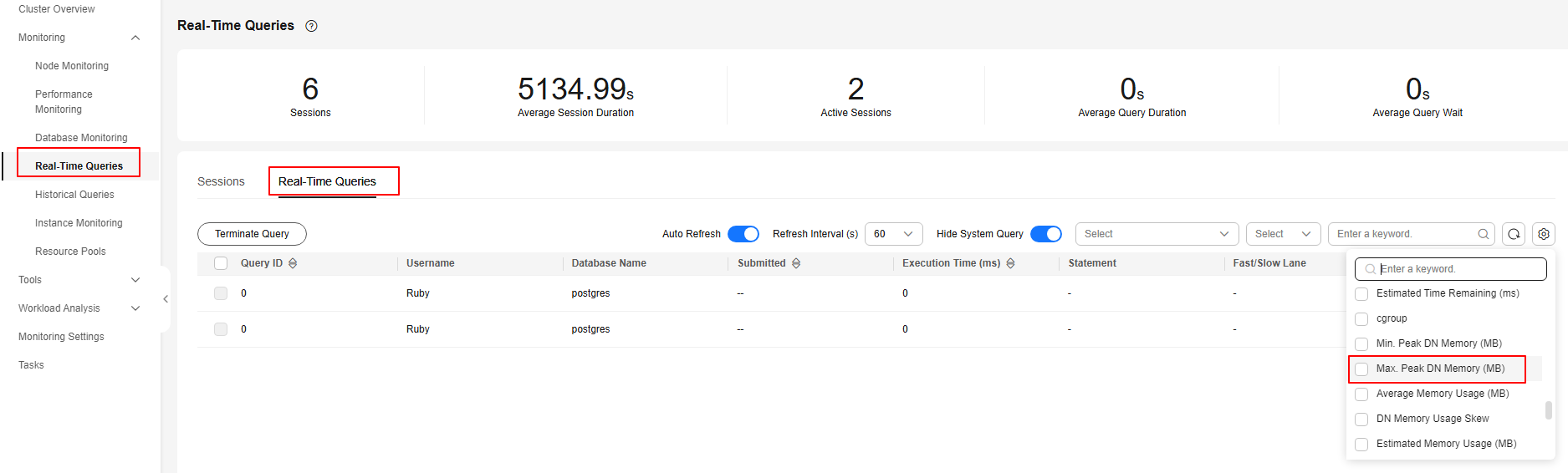

- On the monitoring page, choose Monitoring > Real-Time Queries, click
, and select Max. Peak DN Memory (MB) to view the query that uses the most memory. Figure 3 Viewing memory information
- After confirming with the service side, select the query ID of the query to be stopped and click Stop Query.
