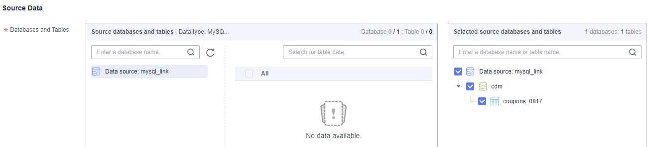

- Configure source parameters.
Select the databases and tables to be synchronized based on the following table.
Table 5 Selecting the databases and tables to be synchronized Synchronization Scenario
Configuration Method
Entire DB
Select the MySQL databases and tables to be migrated.Figure 4 Selecting databases and tables
Both databases and tables can be customized. You can select one database and one table, or multiple databases and tables.

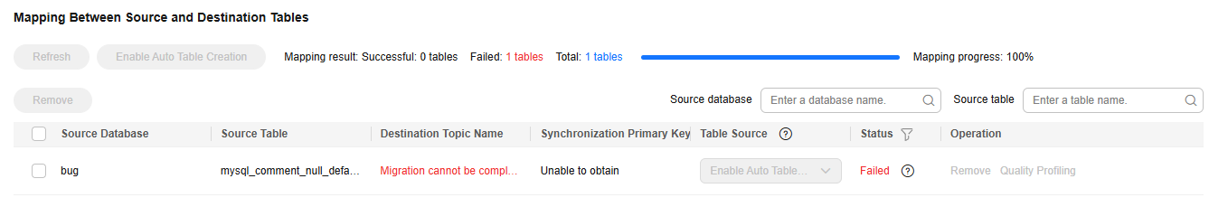

- Update the mapping between the source table and destination table and check whether the mapping is correct.
Table 8 Mapping between source and destination tables Synchronization Scenario
Entire DB
You can change the names of mapped destination topics as needed. You can map one source topic to one destination topic or map multiple source topics to one destination topic.

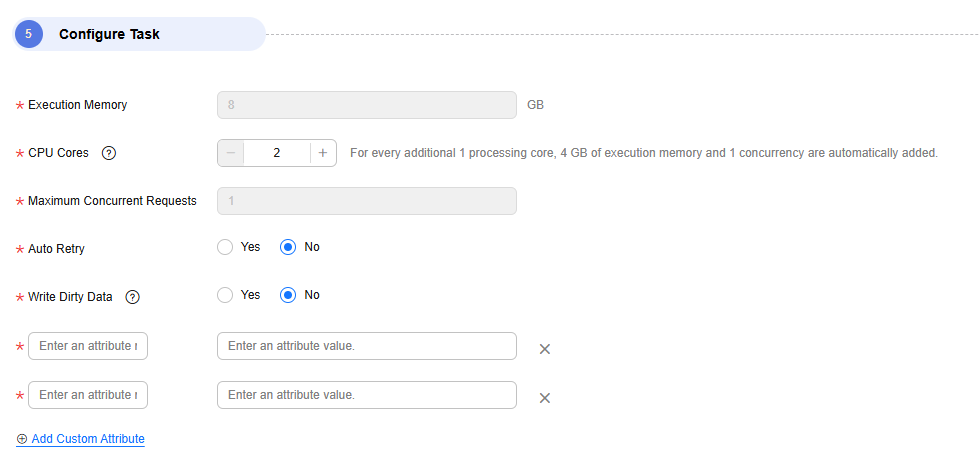

- Configure task parameters.
Table 9 Task parameters Parameter
Description
Default Value
Execution Memory
Memory allocated for job execution, which automatically changes with the number of CPU cores
8GB
CPU Cores
Value range: 2 to 32
For each CPU core added, 4 GB execution memory and one concurrency are automatically added.
2
Maximum Concurrent Requests
Maximum number of jobs that can be concurrently executed. This parameter does not need to be configured and automatically changes with the number of CPU cores.
Custom attributes
You can add custom attributes to modify some job parameters and enable some advanced functions. For details, see Job Performance Optimization.
