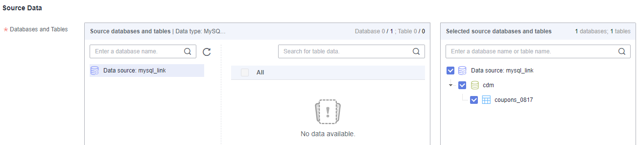

- Select synchronization objects.
- Table-level synchronization: Synchronize multiple tables in multiple databases of a MySQL instance.
- Database-level synchronization: Synchronize all tables in multiple databases of a MySQL instance.
- Select the MySQL databases and tables to be migrated. Figure 4 Selecting databases and tables
Both databases and tables can be customized. You can select one database and one table, or multiple databases and tables.

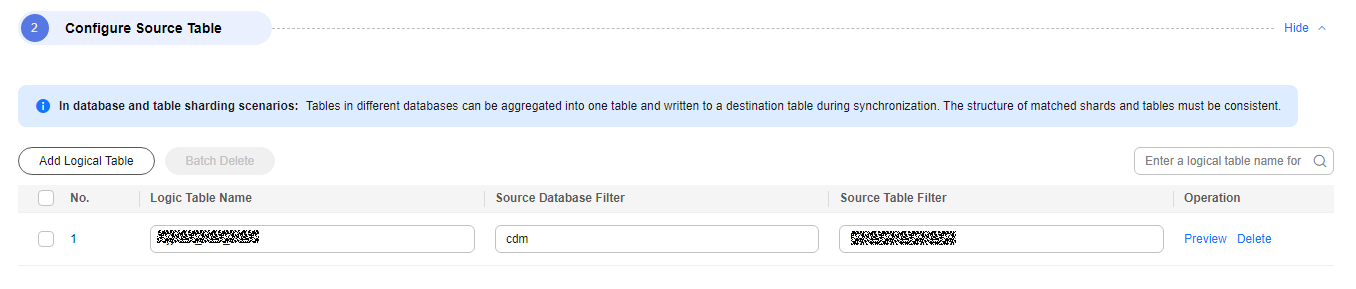

Database/Table partition
Add a logical table.- Logical Table Name: Enter the name of the table to be written to DWS.
- Source Database Filter: You can enter a regular expression to filter all the database shards to be written to the destination GaussDB(DWS) aggregation table.
- Source Table Filter: You can enter a regular expression to filter all the table shards in the source database shard to be written to the destination GaussDB(DWS) aggregation table.
Figure 5 Adding a logical table

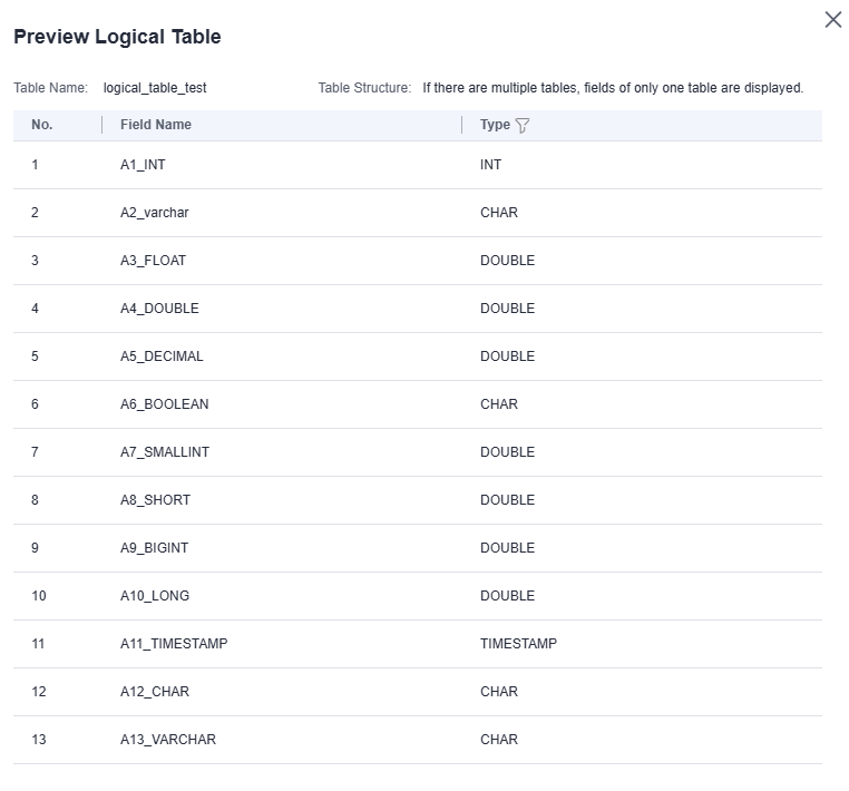

You can click Preview in the Operation column to preview an added logical table. When you preview a logical table, the more the source tables, the longer the waiting time.
Figure 6 Previewing a logical table

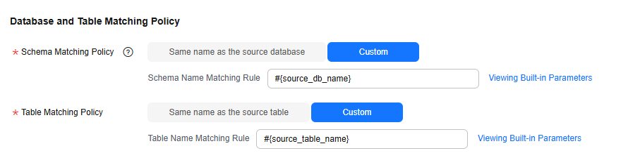

- Set Database and Table Matching Policy.
For details about the matching policy between source and destination databases and tables in each synchronization scenario, see the following table.
Table 6 Database and table matching policy Synchronization Scenario
Configuration Method
Entire DB
- Schema matching policy
- Same name as the source database: Data will be synchronized to the GaussDB(DWS) schema with the same name as the source MySQL database.
- Custom: Data will be synchronized to the GaussDB(DWS) schema you specify.
- Table matching policy
- Same name as the source table: Data will be synchronized to the GaussDB(DWS) table with the same name as the source MySQL table.
- Custom: Data will be synchronized to the GaussDB(DWS) table you specify. Figure 7 Database and table matching policy in the entire database migration scenario
NOTE:When you customize a matching policy, you can use built-in variables #{source_db_name} and #{source_table_name} to identify the source database name and table name. The table matching policy must contain #{source_table_name}.

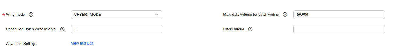

- Configure GaussDB(DWS) parameters.
For details, see the following table.
Figure 9 GaussDB(DWS) parameters
Table 7 GaussDB(DWS) parameters Parameter
Default Value
Unit
Description
Write Mode
UPSERT MODE
N/A
- UPSERT MODE: batch update
- COPY MODE: DWS-dedicated high-performance batch import
Maximum Data Volume for Batch Write
50000
Count
Number of data records written to GaussDB(DWS) in a batch. You can adjust the value based on the table data size and job memory usage.
Scheduled Batch Write Interval
3
Second
Interval at which data is written to GaussDB(DWS)
Advanced Settings
N/A
N/A
Some advanced functions can be configured using parameters. For details, see GaussDB(DWS) advanced parameters.

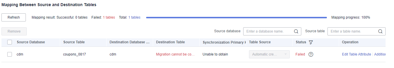

- Refresh and check the mapping between the source and destination tables. In addition, you can modify table attributes, add additional fields, and use the automatic table creation capability to create tables in the destination GaussDB(DWS) database. Figure 10 Mapping between source and destination tables

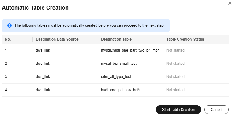

- Automatic table creation: Click Auto Table Creation to automatically create tables in the destination database based on the configured mapping policy. After the tables are created, Existing table is displayed for them. Figure 11 Automatic table creation
- DataArts Migration supports only automatic table creation. You need to manually create databases and schemas at the destination before using this function.
- For details about the field type mapping for automatic table creation, see Field Type Mapping.
- An automatically created Hudi table contains three audit fields: cdc_last_update_date, logical_is_deleted, and _hoodie_event_time. The _hoodie_event_time field is used as the pre-aggregation key of the Hudi table.
