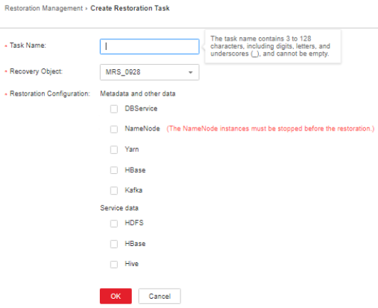

- On FusionInsight Manager, choose O&M > Backup and Restore > Restoring Management. On the displayed page, click Create.
Figure 1 Creating a restoration task
- Set Task Name to the name of the restoration task.
- Set Recovery Object to OMS.
- Select OMS.
- Set Path Type of OMS to a backup directory type.
