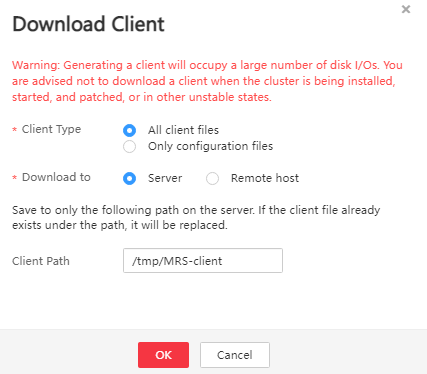

  1. Log in to MRS Manager of cluster A.
  2. Click Services, and then Download Client.
    Figure 1 Downloading a client
  3. Set Client Type to Only configuration files.
  4. Set Download to to Remote host.
  5. Set Host IP Address to the IP address of the active Master node of cluster B, Host Port to 22, and Save Path to /tmp.
    • If the default port 22 for logging in to cluster B using SSH is changed, set Host Port to a new port.
    • The value of Save Path contains a maximum of 256 characters.
  6. Set Login User to root.
    If another user is used, ensure that the user has permissions to read, write, and execute the save path.
  7. Select Password or SSH Private Key for Login Mode.
    • Password: Enter the password of user root set during cluster creation.
    • SSH Private Key: Select and upload the key file used for creating the cluster.
  8. Click OK to generate a client file.

  1. Configure mutual trust between the two clusters and update the client by following the steps in this section.
