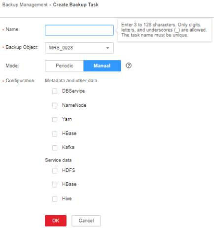

  3. Click Create.
    Figure 1 Creating a backup task.
  4. Set Name to the name of the backup task.
  5. Set Backup Object to OMS.
  6. Set Mode to the type of the backup task.

  7. In Configuration, select OMS.
  8. Select a backup directory type for Path Type of OMS.
