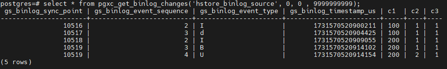

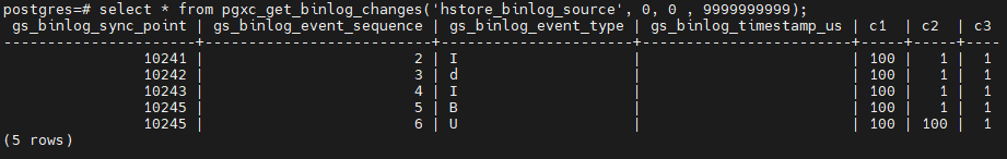

-- Simulate Flink to call a system function to query the binlog of a specified CSN range. The parameters indicate the table name, target DN (0 indicates all DNs), start CSN point, and end CSN point.
select * from pgxc_get_binlog_changes('hstore_binlog_source', 0, 0 , 9999999999);
Two INSERT operations generate two records with gs_binlog_event_type as I. The DELETE operation generates a record whose type is d. The UPDATE operation generates a B record for BeforeUpdate and a U record for AfterUpdate, indicating the values before and after the update.

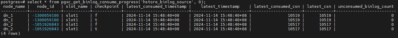

Obtain the consumption progress of the table for which the binlog timestamp function is enabled.
The returned fields indicate the timestamp of the latest consumed binlog, the latest timestamp on the binlog, the CSN point of the latest consumed binlog, the latest CSN point on the binlog, and the number of unconsumed binlog records.
2
3
4
5
-- Simulate Flink to call the system function to register a synchronization point. The parameters indicate the table name, slot name, registered point, whether the point is a checkpoint, and xmin corresponding to the point (provided when the synchronization point is obtained).
select pgxc_register_binlog_sync_point('hstore_binlog_source', 'slot1', 0, 9999999999, false, 100);
select pgxc_register_binlog_sync_point('hstore_binlog_source', 'slot1', 0, 9999999999, true, 100);
-- Query the consumption progress of each slot in the target table.
select * from pgxc_get_binlog_consume_progress('hstore_binlog_source', 0);
