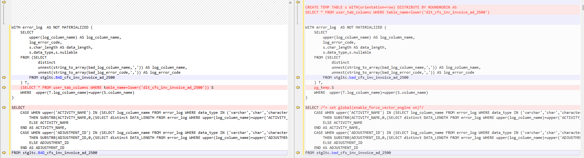

A sub-query run exclusively on a CN. Generally, any sub-query cannot be pushed down if it invokes system catalogs or views, or some functions cannot be pushed down.
Case 1: Using System Catalogs or Views Queried During a Subquery

Rewritten statement
1 2 3 4 5 6 7 8 9 10 11 12 13 14 15 16 17 18 19 20 21 22 23 24 25 26 27 28 29 30 31 32 33 34 35 36 | -- Identify the subquery that cannot be pushed down as the WITH error_log clause. -- SELECT * FROM user_tab_columns WHERE table_name=lower('dlt_cfs_inv_invoice_ad_2500') -- -- This part is a system catalog query, so it can't be pushed down. The result is saved in an intermediate table. -- Create the intermediate table as a row-store table. CREATE TEMP TABLE s WITH(orientation=row) DISTRIBUTE BY ROUNDROBIN AS SELECT * FROM user_tab_columns WHERE table_name=lower('dlt_cfs_inv_invoice_ad_2500') -- All the tables involved in the query are column-store tables, and the temporary table s created earlier is a row-store table. -- Add a hint to use the vectorized executor. WITH error_log AS NOT MATERIALIZED ( SELECT upper(log_column_name) AS log_column_name, log_error_code, s.char_length AS data_length, s.data_type,s.nullable FROM (SELECT distinct unnest(string_to_array(bad_log_column_name,',')) AS log_column_name, unnest(string_to_array(bad_log_error_code,',')) AS log_error_code FROM stgltc.bad_cfs_inv_invoice_ad_2500 ) T, pg_temp.S WHERE upper(T.log_column_name)=upper(S.column_name) ) SELECT /*+ set global(enable_force_vector_engine on)*/ CASE WHEN upper('ACTIVITY_NAME') IN (SELECT log_column_name FROM error_log WHERE data_type IN ('varchar','char','character','nchar','character varying','varchar2','nvarchar2','clob','text') AND log_error_code='22001'/*The string is too long*/) THEN SUBSTRB(ACTIVITY_NAME,0,(SELECT distinct DATA_LENGTH FROM error_log WHERE upper(log_column_name)=upper('ACTIVITY_NAME'))) ELSE ACTIVITY_NAME END AS ACTIVITY_NAME, CASE WHEN upper('ADJUSTMENT_ID') IN (SELECT log_column_name FROM error_log WHERE data_type IN ('varchar','char','character','nchar','character varying','varchar2','nvarchar2','clob','text') AND log_error_code='22001'/* The string is too long.*/ THEN SUBSTRB(ADJUSTMENT_ID,0,(SELECT distinct DATA_LENGTH FROM error_log WHERE upper(log_column_name)=upper('ADJUSTMENT_ID'))) ELSE ADJUSTMENT_ID END AS ADJUSTMENT_ID FROM stgltc.bad_cfs_inv_invoice_ad_2500 |
Modification comparison
