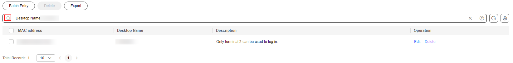

- In the navigation pane, choose Policies > Terminal and Desktop Binding.
The terminal-desktop binding list is displayed.
- Find the binding relationship to be modified.
- Enter the MAC address or desktop name in the search box and click
to select the binding relationships to be modified.
- You can find the desired binding relationships in the binding relationship list.
- Click Edit in the Operation column of the desired binding relationship.
- Modify the MAC address, desktop name, and description as required, and click OK.
