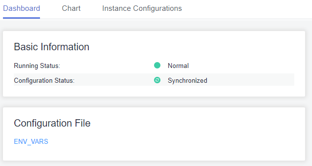

- Click the name of the target instance. In the Configuration File area on the Instance Status page, the configuration file list of the instance is displayed. Figure 1 Viewing the instance configuration file
- Click the name of the configuration file to be viewed to view the parameter values in the configuration file.
To obtain the configuration file, download the configuration file to the local PC.
