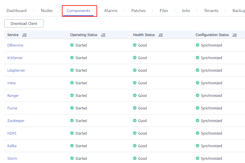

    After the component configuration parameters are saved, some configurations do not take effect immediately. In this case, the configuration status of the component instance changes to Configuration expired. You can wait until the service is idle or all related configurations of other components are modified, and then restart the component to make the configurations take effect.
    In the component list, locate the row that contains the target component, click Restart in the Operation column. Restart the component as prompted. After the component successfully restarts, its Configuration Status changes to Synchronized.

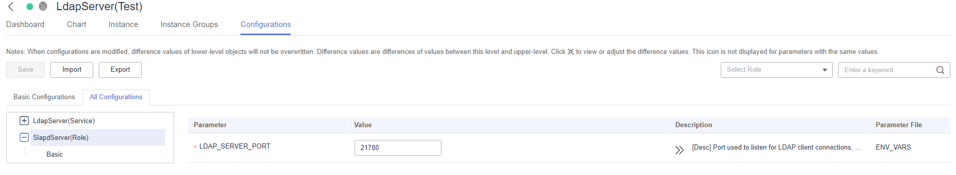

    The Basic Configurations page is displayed by default. To modify more parameters, click All Configurations. The navigation tree displays all configuration parameters of the service. The level-1 nodes in the navigation tree are service names or role names. The parameter category is displayed after the level-1 node is expanded.
    As shown in the following figure, LdapServer indicates the service name, indicating that the configuration applies to the entire service; SlapdServer indicates the role name, indicating that the configuration applies to all instances in the role.
    Figure 1 Configuration parameter navigation tree
    The parameters under the service node are service-level configuration parameters, and the parameters under the role node are role-level configuration parameters. For details, see Modifying MRS Role Instance Parameters.
