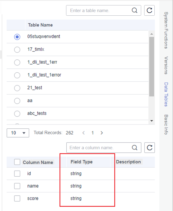

select ${str1} from data; - Visualized reading of data tables to generate SQL statements
Click Data Tables on the right of the editor to display all the tables in the current database or schema. You can select tables and columns and click Generate SQL Statement in the lower right corner to generate an SQL statement, which you need to manually format.

Data Table
You can view tables of Hive SQL, Spark SQL, DLI SQL, Doris SQL, RDS SQL, and DWS SQLsingle-task batch processing jobs. On the Data Tables slide-out panel, you can select a table name to view the column names, field types, and descriptions in the table.

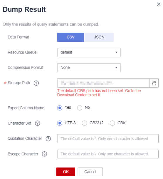

Downloading or Dumping Script Execution Results
- After executing a script, you can click Download on the Result tab page to download a CSV result file to a local path. You can view the download record on the Download Center page.
- After executing a script, you can click Dump on the Result tab page to dump a CSV and a JSON result file to OBS. For details, see Table 7.
- The dump function is supported only if the OBS service is available.
- Only the execution results of SQL script query statements can be dumped.
- If the execution result of a download or dump SQL statement contains commas (,), newline characters, or other special characters, data may be disordered, the number of rows may increase, or other issues may occur.
Table 7 Dump parameters Parameter
Mandatory
Description
Data Format
Yes
Format of the data to be exported. CSV and JSON formats are supported.
Resource Queue
No
DLI queue where the export operation is to be performed. Set this parameter when a DLI or SQL script is created.
Compression Format
No
Format of compression. Set this parameter when a DLI or SQL script is created.
- none
- bzip2
- deflate
- gzip
Storage Path
Yes
OBS path where the result file is stored. After selecting an OBS path, customize a folder. Then, the system will create it automatically for storing the result file.
You can also go to the Download Center page to set the default OBS path, which will be automatically set for Storage Path in the Dump Result dialog box.
Cover Type
No
If a folder that has the same name as your custom folder exists in the storage path, select a cover type. Set this parameter when a DLI or SQL script is created.
- Overwrite: The existing folder will be overwritten by the customized folder.
- Report: The system reports an error and suspends the export operation.
Export Column Name
No
Yes: Column names will be exported.
No: Column names will not be exported.
Character Set
No
- UTF-8: default character set
- GB2312: recommended when the data to be exported contains Chinese character sets
- GBK: expanded based on and compatible with GB2312
Quotation Character
No
This parameter is available and can be set only when Data Format is csv.
Quotation characters are used to identify the beginning and end of text fields when exporting job results, and are used to separate fields.
Only one character can be set. The default value is double quotation marks (").
This is mainly used to handle data that contains spaces, special characters, or characters that are the same as the delimiter.
For details about the examples of using quotation characters and escape characters, see Example of Using Quotation Characters and Escape Characters.
Escape Character
No
If special characters, such as quotation marks, need to be included in the exported results, they can be represented using escape characters (backslash \).
Only one character can be set. The default value is a backslash (\).
Common scenarios for using escape characters are:
- If there is a third quotation mark between two quotation marks, add an escape character before the third quotation mark to prevent the field content from being split.
- If there is already an escape character in the data content, add another escape character before the existing one to avoid the original character being used as an escape character.

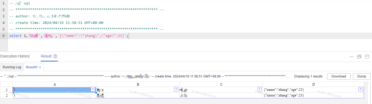

- Usage of quotation characters and escape characters:
- Quotation character: used to identify and separate fields. The default value is double quotation marks (").
- Escape character: If special characters, such as quotation marks, need to be included in the exported results, they can be represented using escape characters (backslash \). The default value is a backslash (\).
- To prevent the content of a field from being split when there is a third quotation character between two quotation characters, add an escape character before the third quotation character.
- Example:
You can leave Quotation Character and Escape Character empty.
If you leave them empty, the downloaded .csv file contains two rows in Excel.
If you specify both of them, for example, enter double quotation marks ("), the downloaded file is as follows.
