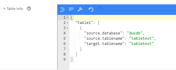

Table Info
{"table1":[{"source.database":"dwsdb","source.tablename":"tabletest","target.tablename":"tabletest"}]}

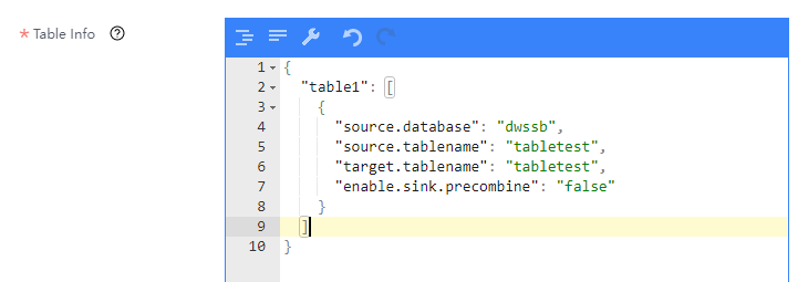

- Data can be synchronized from Hudi to GaussDB(DWS) only when both Hudi and GaussDB(DWS) contain the precombine field.
- GaussDB(DWS) tables must contain the precombine field and the primary key.
- By default, the Hudi built-in field _hoodie_event_time is used. If this field is not used, enable.sink.precombine must be specified. An example is as follows:

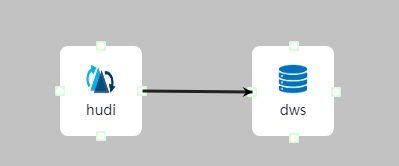

- Drag the two icons to associate the job parameters and click Save. The job configuration is complete.
- In the job list on the Job Management page, locate the created job, click Start in the Operation column, and wait until the job is started.
