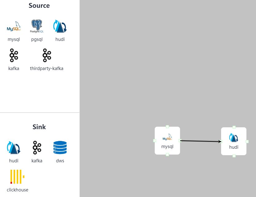

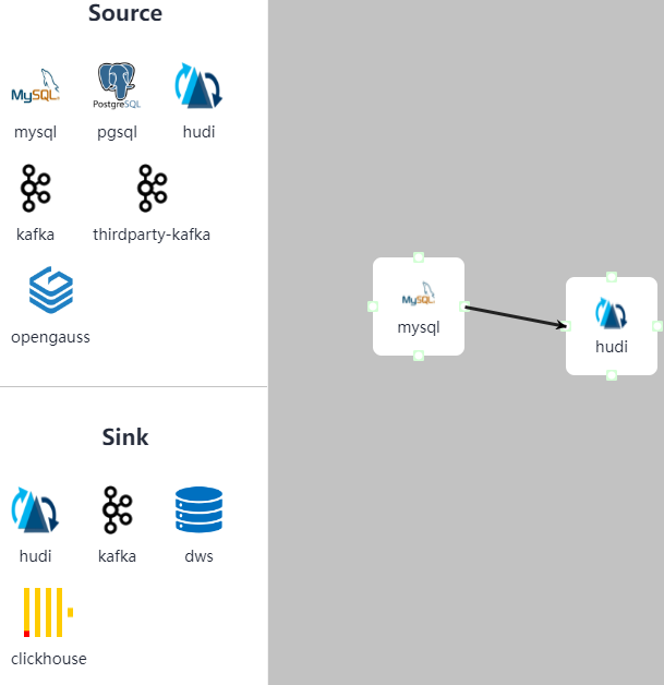

- On the Job Management page, select and drag the target element from Source and Sink to the GUI on the right.
MRS 3.2.0:
MRS 3.3.0 and later versions:
Double-click the two elements to connect them and set related parameters as required.
