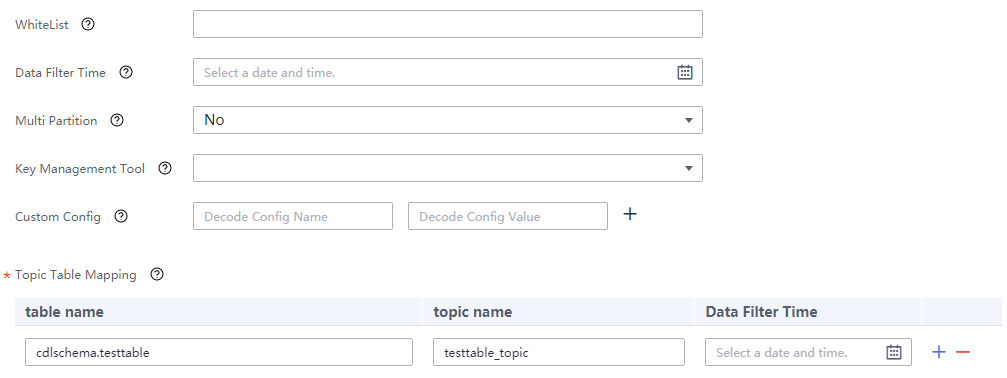

  6. Configure OpenGauss job parameters.
    1. On the Job Management page, drag the opengauss icon on the left to the editing area on the right and double-click the icon to go to the OpenGauss job configuration page. Set parameters by referring to the following table. Creating a CDL Data Synchronization Job describes the job parameters.
      Table 4 OpenGauss job parameters
      Parameter
      Example
      Link
      opengausslink
      Tasks Max
      Mode
      insert, update, and delete
      dbName Alias
      opengaussdb
      Slot Name
      oct_twenty_two
      Slot Drop
      No
      Connect With Hudi
      Yes
      Topic Table Mapping
      cdlschema.testtable/testtable_topic
    2. Click OK. The OpenGauss job parameters are configured.

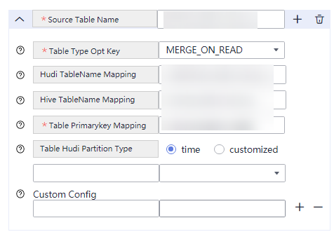

  7. Configure Hudi job parameters.
    1. On the Job Management page, drag the hudi icon in the Sink area on the left to the editing area on the right and double-click the icon to go to the Hudi job configuration page. Set parameters by referring to the following table. Creating a CDL Data Synchronization Job describes the job parameters.
      Table 5 Sink Hudi job parameters
      Parameter
      Example
      Link
      hudilink
      Path
      /cdl/test
      Interval
      5
      Max Rate Per Partition
      0
      Parallelism
      10
      Configuring Hudi Table Attributes
      Visual View
      Global Configuration of Hudi Table Attributes
      Configuring the Attributes of the Hudi Table: Source Table Name
      cdlschema.testtable
      Configuring the Attributes of the Hudi Table: Table Type Opt Key
      MERGE_ON_READ
      Configuring the Attributes of the Hudi Table: Hudi TableName Mapping
      testtable or /cdlschema/testtable
      Configuring the Attributes of the Hudi Table: Hive TableName Mapping
      cdlschema.testtable
      Configuring the Attributes of the Hudi Table: Table Primarykey Mapping
      so_line_id,order_number
      Configuring the Attributes of the Hudi Table: Table Hudi Partition Type
      time
      Configuring the Attributes of the Hudi Table: Custom Config
    2. (Optional) Select the created ENV. The default value is defaultEnv.
    3. Click OK.
  8. Drag the two icons to associate the job parameters and click Save. The job configuration is complete.
