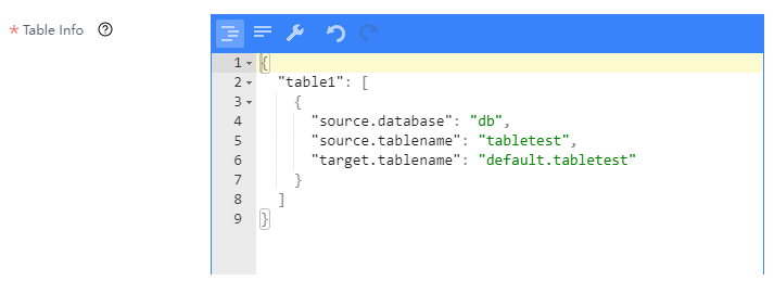

- On the Job Management page, drag the hudi icon in the Source area on the left to the editing area on the right and double-click the icon to go to the Hudi job configuration page. Configure parameters based on the following table. For details about job parameters, see Creating a CDL Data Synchronization Job.
Table 4 Source Hudi job parameters Parameter
Example
Link
hudilink
Interval
10
Table Info
{"table1":[{"source.database":"db","source.tablename":"tabletest","target.tablename":"default.tabletest"}]}
NOTE:You do not need to configure the fields provided by Hudi. You only need to configure the service fields that need to be synchronized to ClickHouse.

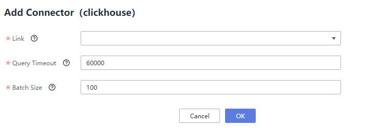

- On the Job Management page, drag the clickhouse icon on the left to the editing area on the right and double-click the icon to go to the ClickHouse job configuration page. Configure parameters based on the following table. For details about job parameters, see Creating a CDL Data Synchronization Job.
Table 5 ClickHouse job parameters Parameter
Example
Link
cklink
Query Timeout
60000
Batch Size
100
- Click OK.

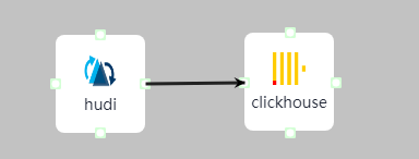

- Drag the two icons to associate the job parameters and click Save. The job configuration is complete.
