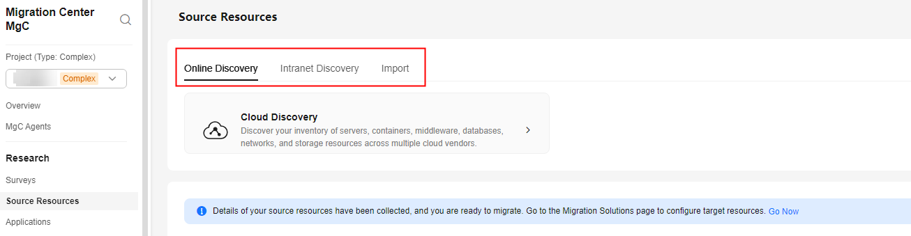

- Discover source servers. MgC provides three collection methods to meet your requirements in different scenarios. You can choose a method based on your source environment.Figure 1 Collection methods
- If your source servers are on a cloud platform, such as Alibaba Cloud, Huawei Cloud, AWS, Tencent Cloud, or Azure, you can collect the data about your servers over the Internet. You can also manually add the server data to MgC.
- If your source servers are in an on-premises IDC, you can collect the server data over the intranet. MgC enables you to scan for servers by network range or VMware vCenter Server. You can also manually add the server data to MgC.

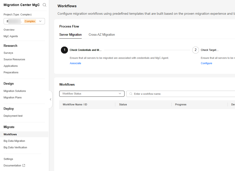

- Create a server migration workflow. After all the preceding steps are complete, go to the Workflows page and create a server migration workflow.
- A workflow can contain a maximum of 100 servers.
- You can migrate a maximum of 1,000 servers concurrently. For any servers beyond this number, the workflows will pause at the first step and put these servers in a pending state until other servers complete their migration. The workflows will then automatically start on these servers in the order the workflows were created.
- If this is your first time to create a server migration workflow, you need to assign MgC the required permissions. For more information about the required permissions, see Agency Permissions.
- In the navigation pane, choose Workflows. In the upper left corner of the page, select the migration project you created.
- Select the Server Migration template and click Configure Workflow.
- In the Workflow Details area, customize Name and Description.
