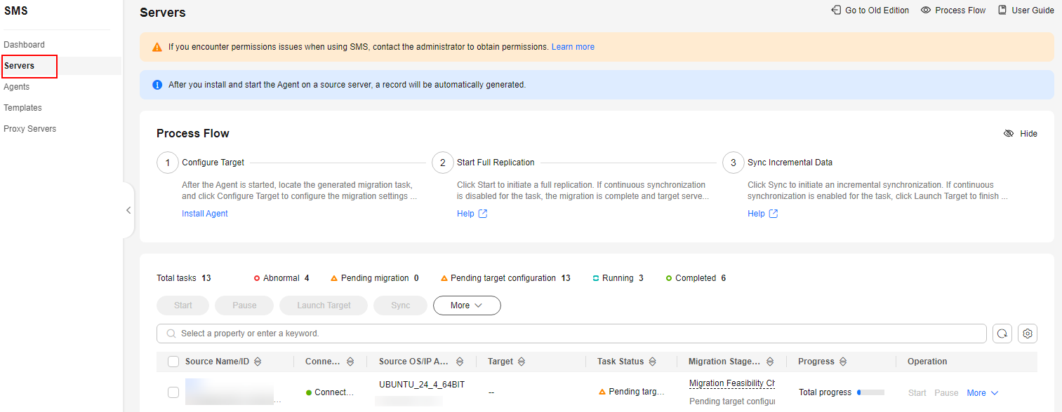

- Sign in to the SMS console.

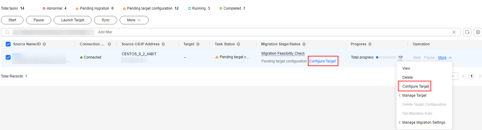

- In the navigation pane on the left, choose Servers.Figure 1 Server list
- In the server list, locate the source server and click Configure Target in the Migration Stage/Status column.You can also choose More > Configure Target in the Operation column.
If you do not find the record for your source server, check that the account you are currently using is the migration account.

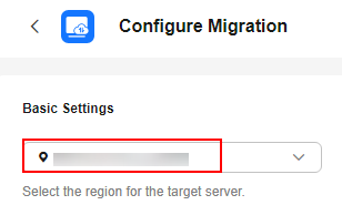

- Click Next: Configure Target in the lower right corner.
- In the Basic Settings area, select the region you are migrating to.

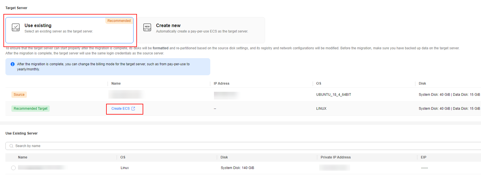

- In the Target Server area, choose whether to use an existing cloud server or create a new one as the target server. For details about the requirements on target servers, see .
- Use existing
In the list of existing servers, select one that meets the specifications requirements displayed in the Recommended Target row. If no existing server meets the requirements, click Create ECS and purchase an ECS with the required specifications. For details, see Purchasing an ECS.
You can select a pay-per-use or yearly/monthly ECS.

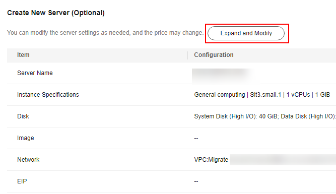

- Create new
The system automatically presets the name, AZ, specifications, disk specifications, EIP, VPC, subnet, and security group for the target server. You can also click Expand and Modify to manually modify the server settings.

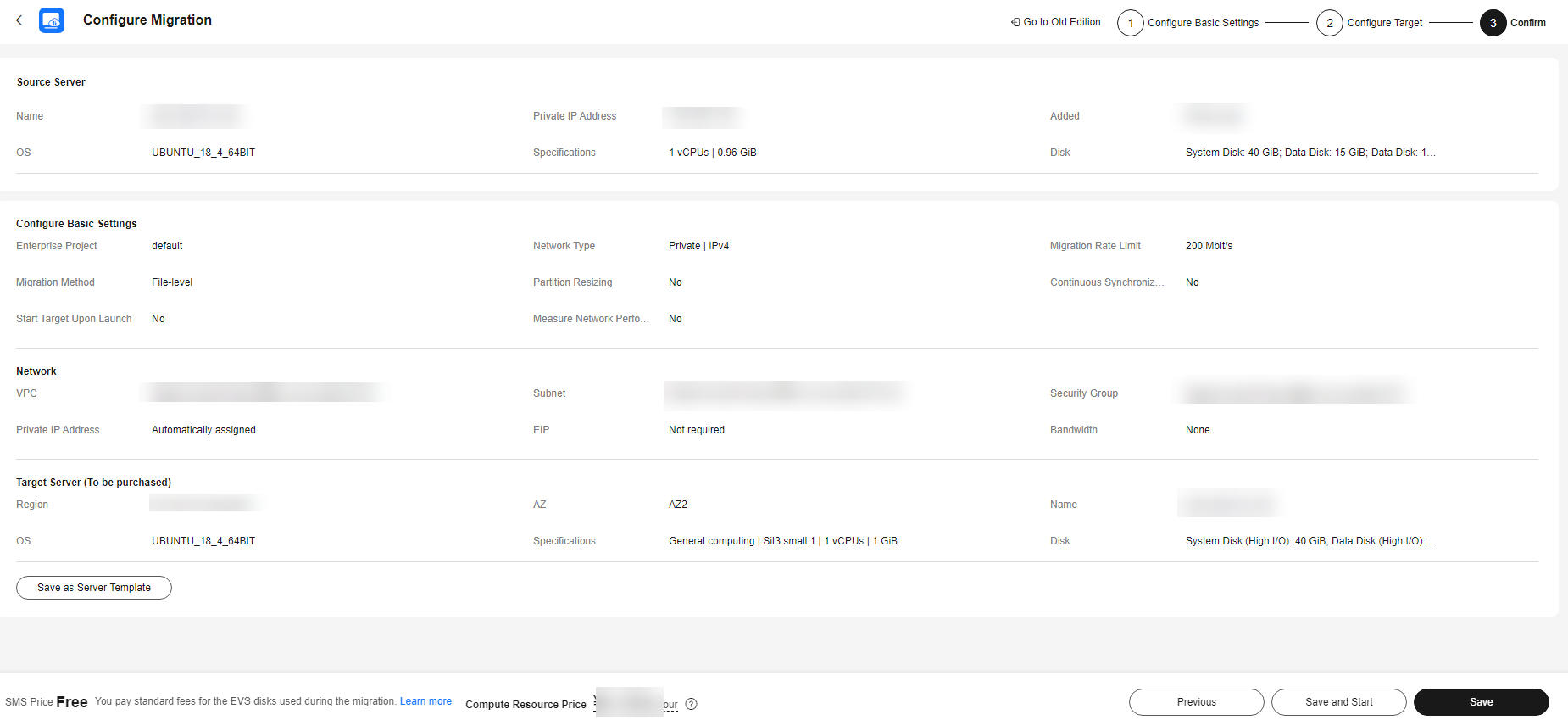

- Click Next: Confirm in the lower right corner.Figure 2 The configuration confirmation page

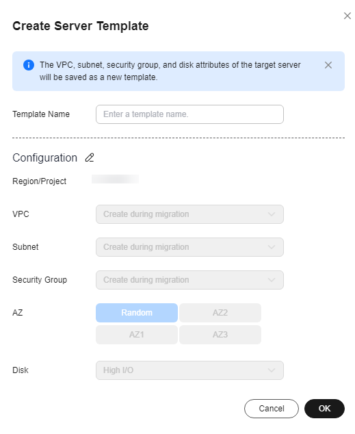

- (Optional) Click Save as Server Template. In the displayed Create Server Template dialog box, enter a template name and click OK to save the target server settings as a template.
Save as Server Template is available only when you select Create new for Server.
Figure 3 Create Server Template

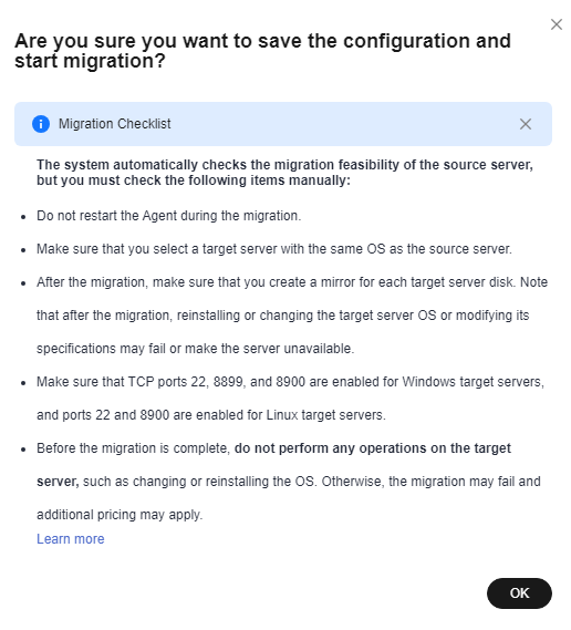

- Confirm the configuration and click Save. In the displayed dialog box, read the migration conditions and click OK.If you want to start the migration immediately, click Save and Start. In the displayed dialog box, read the migration conditions and click OK.Figure 4 Saving the configuration
Figure 5 Saving the configuration and starting the migration

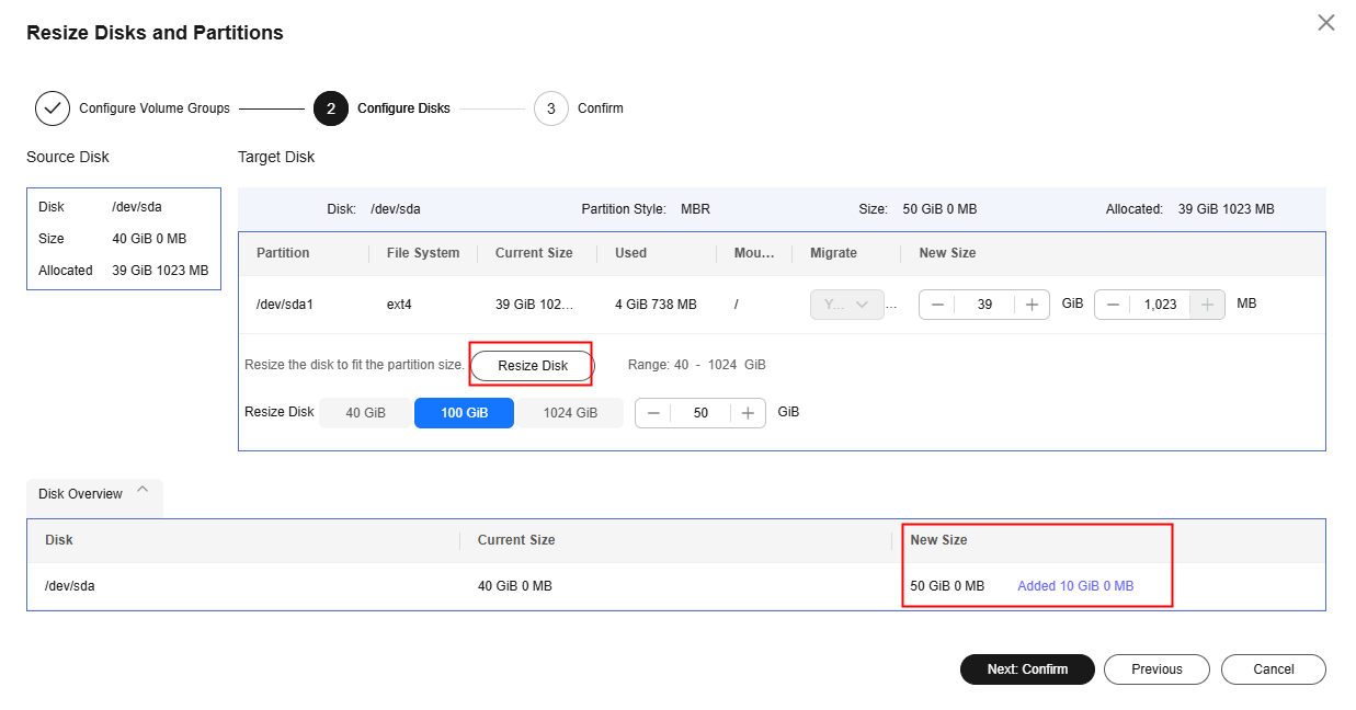

Resizing Disks and Partitions on Linux
- On the Configure Migration page, on Configure Basic Settings page, expand Migration Settings (Optional), enable Resize Disks and Partitions, and click Resize Disks and Partitions.
- Configure volume groups.
- If the source server uses LVM, you can resize logical and physical volumes.
- If the source server does not use LVM, skip this step.
- Click Next: Configure Disks.
- Click Resize Disk and adjust the size of each disk as required. As shown in Resizing disks and partitions (Linux), you can view the resized disks at the bottom of the window.
- If the total partition size after resizing is larger than the disk size, you need to expand the disk capacity to fit the partition size.
- If the total partition size after resizing is much smaller than the disk size, you can downsize the disk.
- Click Next: Confirm. Confirm the configurations and click OK.
