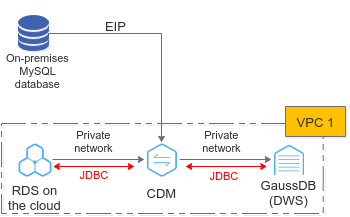

CDM can migrate an entire cloud/on-premises MySQL database or a single table. The migration of an on-premises MySQL database is used as an example.
- On-premises MySQL data migration:
CDM accesses the MySQL database through the public IP address. CDM and DWS are in the same VPC. CDM establishes JDBC connections respectively with MySQL and DWS.
- Cloud RDS for MySQL data migration:
RDS, CDM, and DWS are in the same VPC. CDM establishes JDBC connections respectively with MySQL and DWS. If cloud RDS and DWS are not in the same VPC, CDM uses the EIP to access RDS.

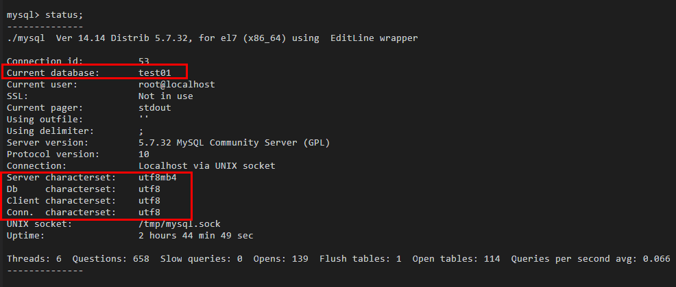

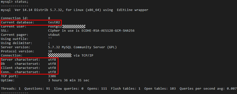

- Analyze the name and code of the databases to be migrated, and the name and attributes of the tables to be migrated.
For example, the destination MySQL databases to be migrated are test01, test02, and the encoding format. The test01 library contains the orders, persons, and persons_b tables and the persons_beijing view. The test02 library contains the persons_c table.
- Query the database name.
1show databases;
- Query the database code.
1 2
use <databasename>; status;
Figure 2 Query database code 1
Figure 3 Query database code 2

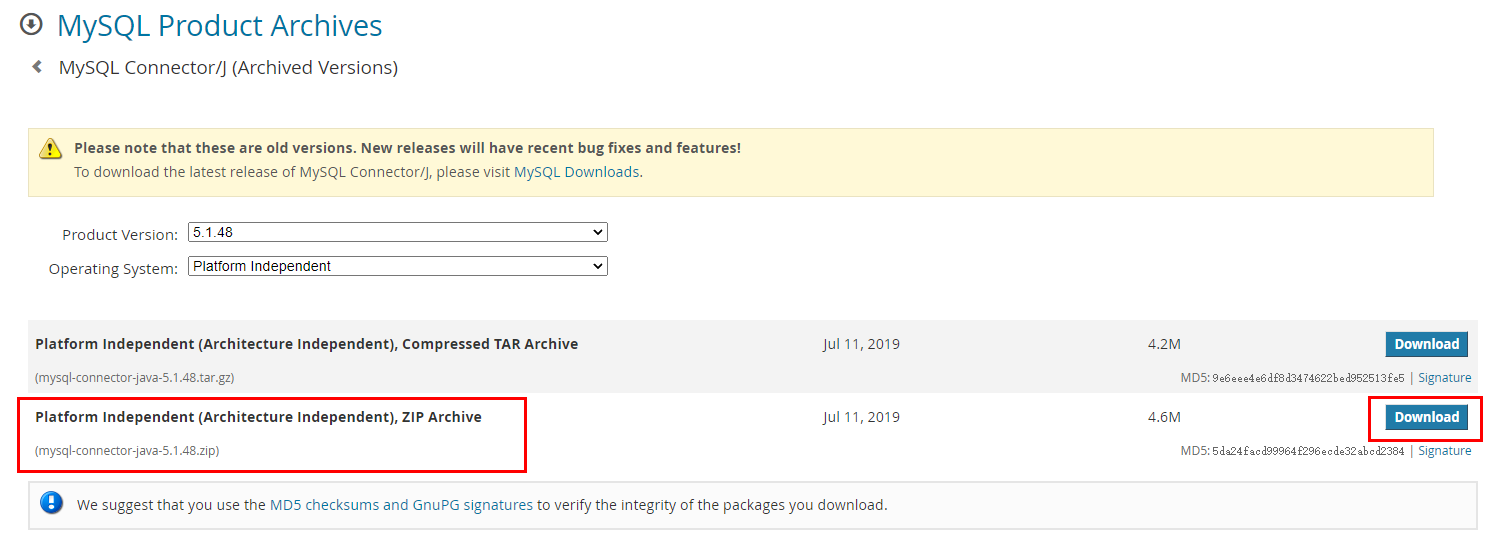

- When creating a MySQL connection for the first time, upload a driver.
- Access the MySQL driver and download the 5.1.48 version. Figure 7 Downloading a driver
- Download the package to the local host and decompress it to obtain mysql-connector-java-xxx.jar.
- On the Cluster Management page, click Job Management in the Operation column of the cluster and choose Links > Driver Management.
- Click Upload on the right of MySQL, select mysql-connector-java-xxx.jar, and click Upload.

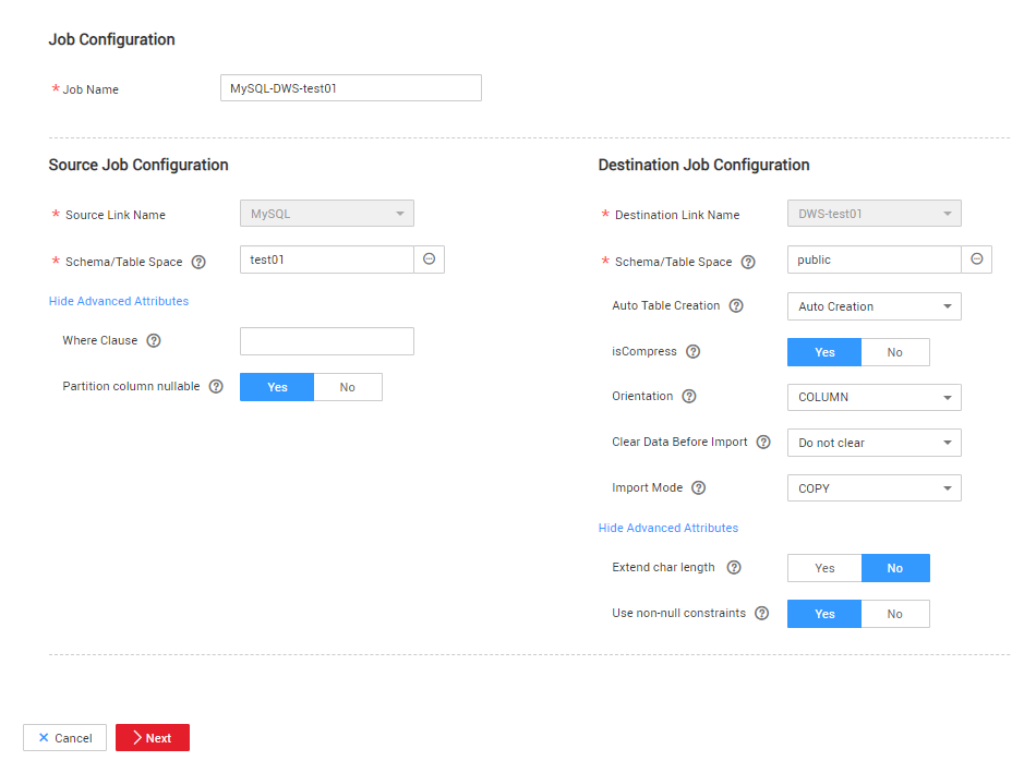

- On the Cluster Management page, click Job Management in the Operation column of the cluster and choose Entire DB Migration > Create Job.
- Set the following parameters and click Next.
- Job Name: MySQL-DWS-test01
- Source Job Configuration:
- Source Link Name: MySQL
- Destination Job Configuration:
- Destination Link Name: DWS-test01
- Automatic Table Creation: The table is created when it does not exist.
- isCompress: Yes
- Orientation: COLUMN
- Retain the default value for other settings.
Figure 8 Configuring a Job

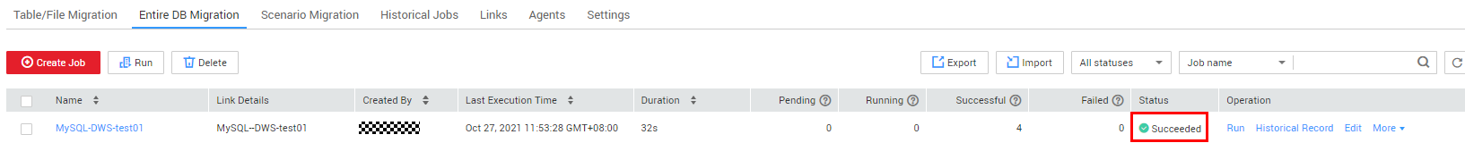

- Check the job running status. If the status is Succeeded, the migration is successful. Figure 9 Viewing the job running status

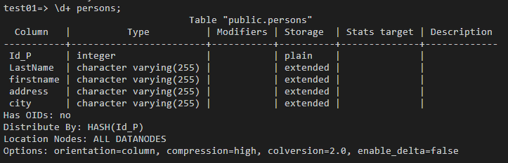

- Check whether the data in each table is complete and whether the columns are complete.
1 2
select count(*) from table name; \d+ table name;
Figure 11 Querying table fields
Figure 12 Querying table data

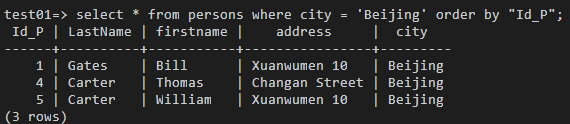

- Perform sampling check to verify table data.
1select * from persons where city = 'Beijing' order by id_p;
Figure 13 Verifying table data
