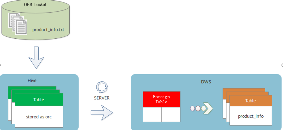

An HDFS foreign table is created to enable DWS to remotely access or read MRS data sources. DWS transmits data through foreign servers and foreign tables. The practice simulates the process of writing data from ORC table data stored in MRS Hive to DWS by creating a cross-source foreign server and foreign table.
A foreign server is a virtual object configured in a database. It is used to define parameters (such as the address, protocol, and authentication information) for connecting to an external data source. Through the foreign servers, the local database can directly query and insert external data, just like operating local tables. (The syntax is similar, but may be restricted by performance or functions.)
A foreign table is a virtual table in a database. Data is stored outside the database system (such as file systems, other databases, and cloud storage). However, through the definition and access interface of the table schema (metadata), users can query the external data using standard SQL statements without importing the data to the database.
Based on the type of the interconnected data source, there are HDFS foreign tables and OBS foreign tables. The former reads data from the HDFS distributed file system and the latter reads data from the OBS object storage service.
This practice takes approximately 1 hour. The basic procedure is as follows:
  1. Step 1: Buy an MRS Cluster and Prepare the ORC Table Data Source of MRS: Create an MRS analysis cluster, upload the local TXT data files to an OBS bucket, and import the files to a Hive storage table, and then to an ORC storage table.
  2. Step 2: Create an MRS Data Source Connection: Create an MRS data source on the DWS console. By default, a foreign server named mrs is generated.
  3. Step 3: Create a Foreign Table: Create an HDFS foreign table to access data on MRS.
  4. Step 4: Import Data: Import data to a local DWS table through an HDFS foreign table.

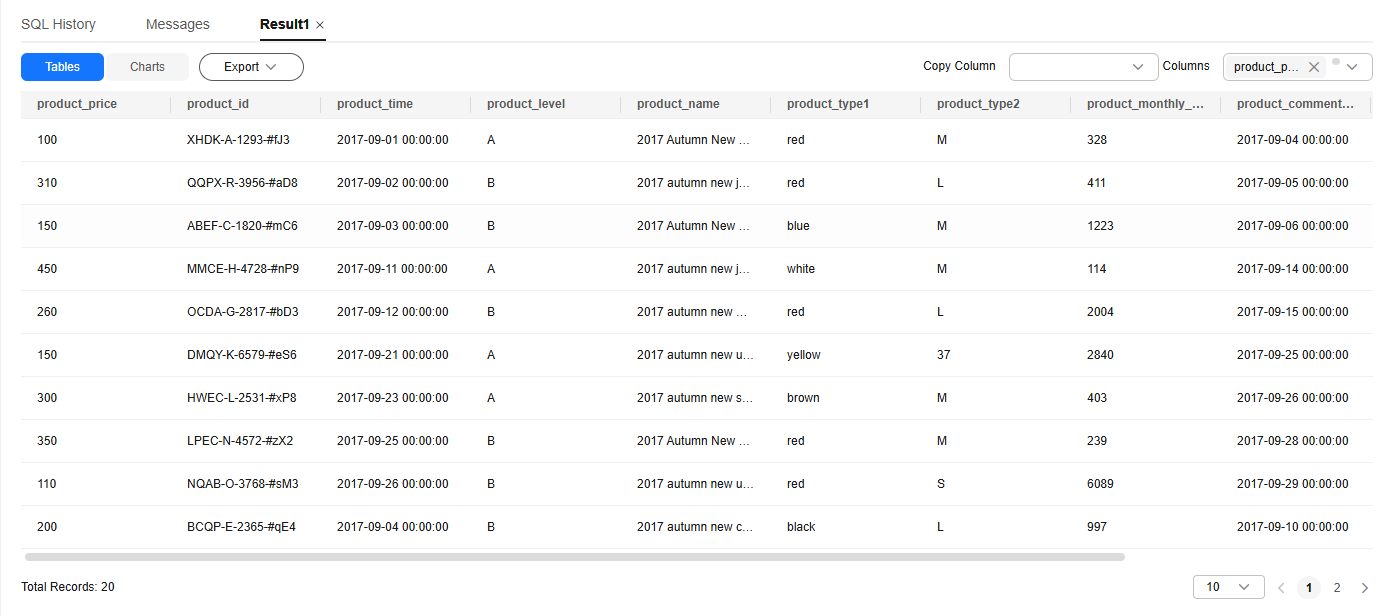

    3. Query whether the data import is successful.
      SELECT * FROM product_info_orc;

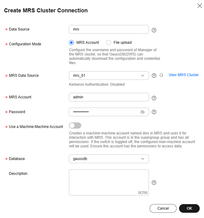

  1. Log in to the DWS console. In the navigation pane, choose Dedicated Clusters > Clusters. Click the created DWS cluster. Ensure that the DWS cluster and MRS are in the same region, AZ, and VPC subnet.
  2. In the navigation pane, choose Data Source > MRS Data Source and click Create MRS Cluster Connection.
  3. Configure the parameters listed in the following table, retain the default values for other parameters, and click OK.
    Table 3 Parameters
    Parameter
    Value
    Data Source
    mrs
    Configuration Mode
    MRS Account
    MRS Data Source
    mrs_01 created in the previous step
    MRS Account
    admin
    Password
    User-defined password
    Database
    gaussdb

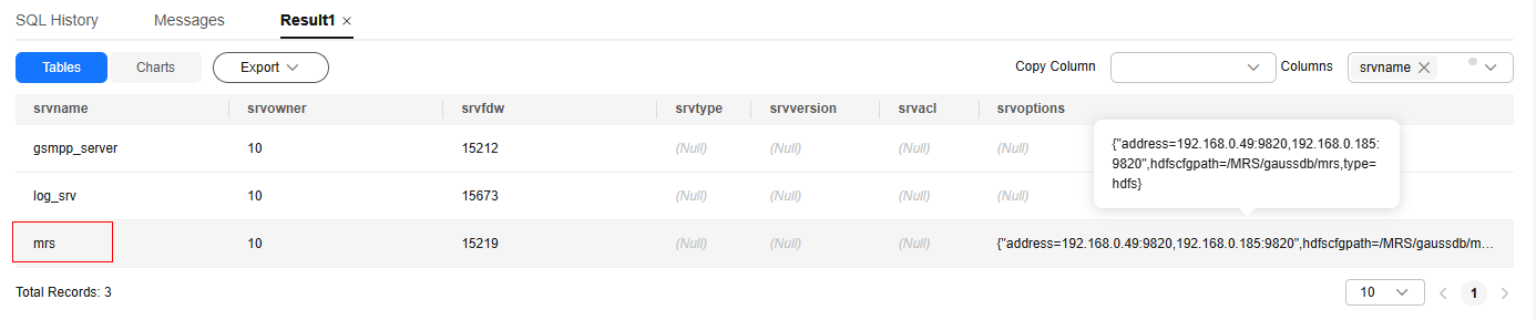

  2. View the external servers in the system.
    SELECT * FROM pg_foreign_server;
    The query result shows that after the MRS data source is created, the system automatically generates an external server named mrs.

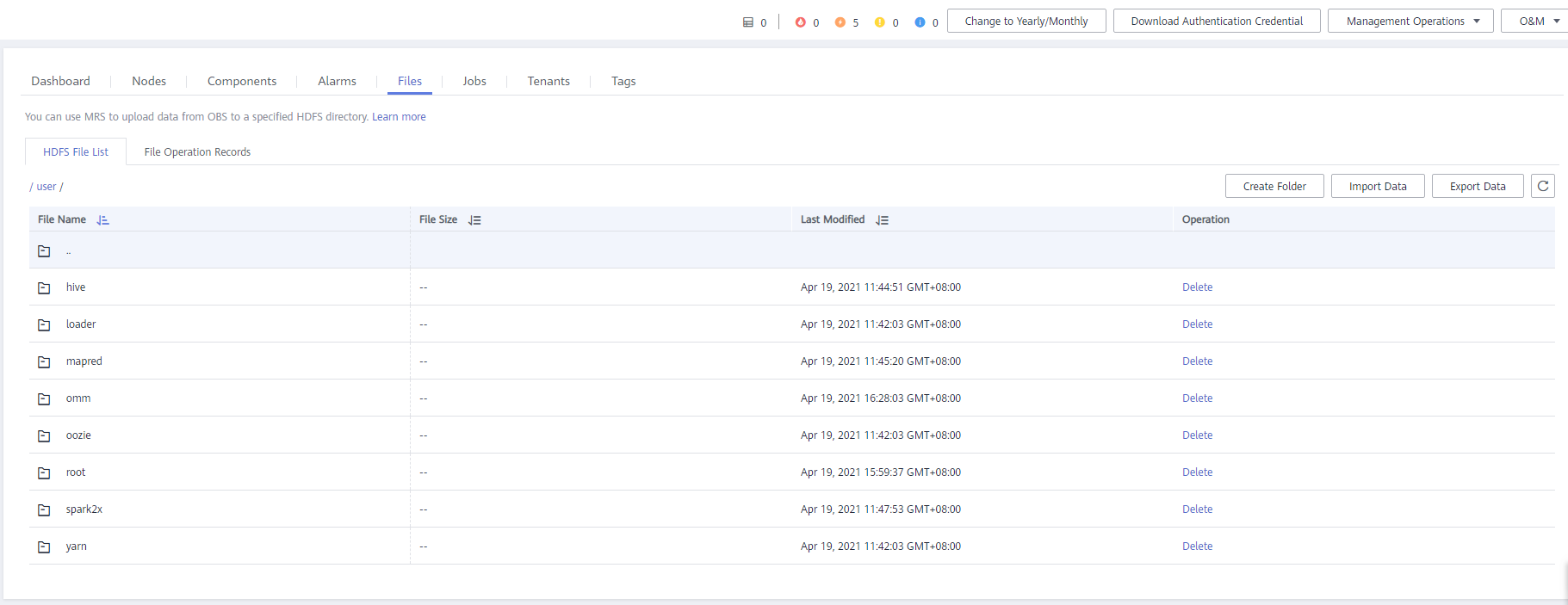

  3. Obtain the product_info_orc file path of Hive.
    1. Log in to the MRS console.
    2. Choose Cluster > Active Cluster and click the name of the cluster to be queried to enter the page displaying the cluster's basic information.
    3. Click the Files and click HDFS File List.
    4. Go to the storage directory of the data to be imported to the DWS cluster and record the path.
      Figure 1 Checking the data storage path on MRS

  3. Query the import result.
    SELECT * FROM product_info;
