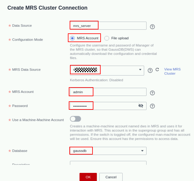

Creating an MRS Cluster Connection
  1. Log in to the DWS console and click the created DWS cluster. Ensure that the DWS cluster and MRS are in the same region, AZ, and VPC subnet.
  2. Click the MRS Data Source tab and click Create MRS Cluster Connection.
  3. Set the following parameters and click OK.
    • Data Source: mrs_server
    • Configuration Mode: MRS Account
    • MRS Data Source: Select the created mrs_01 cluster.
    • MRS Account: admin
    • Password: Enter the password of the admin user created for the MRS data source.
