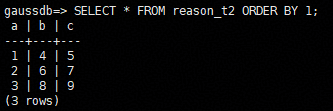

向表reason_t2中插入数据,一条有冲突,一条无冲突。有冲突的数据进行更新,无冲突的数据进行插入,EXCLUDED.b和EXCLUDED.c分别表示引用插入值的b列和c列,本例中为4,5。
2
INSERT INTO reason_t2 VALUES (1, 4, 5),(3, 8, 9) ON CONFLICT(a) DO UPDATE SET b = EXCLUDED.b, c = EXCLUDED.c;
SELECT * FROM reason_t2 ORDER BY 1;

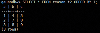

根据过滤条件筛选被更新的行:
2
INSERT INTO reason_t2 VALUES (2, 7, 8) ON CONFLICT (a) DO UPDATE SET b = excluded.b, c = excluded.c  WHERE reason_t2.c = 7;

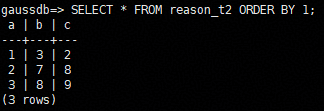

向表reason_t中插入数据,有冲突的数据进行更新并调整更新映射关系,即c列更新到b,b列更新到c:
2
INSERT INTO reason_t2 VALUES (1, 2, 3) ON CONFLICT (a) DO UPDATE SET b = excluded.c, c = excluded.b;
