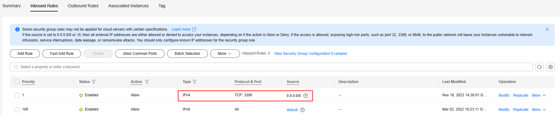

- In the Network Information area, click the security group name in the Security Group field.

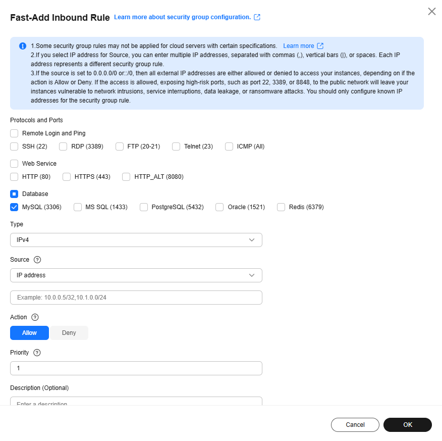

- On the Inbound Rules tab, check whether access through port 3306 is allowed by default. Figure 6 Allowing access through port 3306
If there is no such rule, click Fast-Add Rule. In the displayed dialog box, select MySQL (3306), set the inbound rule parameters, and click OK.
Figure 7 Fast adding port 3306
Table 2 Inbound rule parameter description Parameter
Description
Protocols and Ports
Select MySQL (3306).
Type
Supported source IP address type. Its value can be:
- IPv4
- IPv6
Source
Used to match the source of an external request. The source can be:
- IP address: The source is a fixed IP address. You can enter or paste multiple IP addresses separated by commas (,). Each IP address represents a different security group rule.
- Single IP address: IP address/mask
Example IPv4 address: 192.168.10.10/32
Example IPv6 address: 2002:50::44/128
- IP address range in CIDR notation: IP address/mask
Example IPv4 address range: 192.168.52.0/24
Example IPv6 address range: 2407:c080:802:469::/64
- Any IP addresses
0.0.0.0/0 represents all IPv4 addresses.
::/0 represents all IPv6 addresses.
- Security group: The source is another security group. You can select a security group in the same region from the drop-down list. If there is instance A in security group A and instance B in security group B, and the inbound rule of security group A allows traffic from security group B, traffic is allowed from instance B to instance A.
- IP address group: The source is an IP address group. An IP address group is a collection of one or more IP addresses. You can select an available IP address group from the drop-down list. For IP address ranges and IP addresses with the same security requirements, you can use an IP address group to simplify management.
If no IP address groups are available, create one by referring to Creating an IP Address Group.
Action
A security group rule action. The value can be Allow or Deny.- If Action is set to Allow, the rule allows the source addresses to access specified ports of the cloud servers within the security group.
- If Action is set to Deny, the rule blocks the source addresses from accessing specified ports of the cloud servers within the security group.
Security group rules are matched first by priority and then by action. Deny rules take precedence over allow rules.
Priority
Priority of the security group rule.
The priority value ranges from 1 to 100. The default value is 1, which has the highest priority. The security group rule with a smaller value has a higher priority.
Description
Supplementary information about the security group rule. This parameter is optional.
The description can contain a maximum of 255 characters and cannot contain angle brackets (<>).
