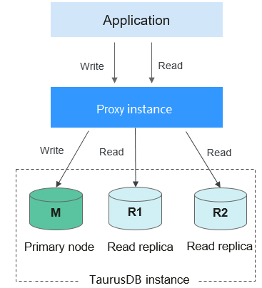

You can create one or more proxy instances for your TaurusDB instance to enable read/write splitting.
If your TaurusDB instance has only one proxy instance, applications connect to the proxy instance through the proxy address. Write requests are forwarded to the primary node and read requests to the primary node or read replicas based on the routing policy you specify.
Figure 1 Read/write splitting with only one proxy instance

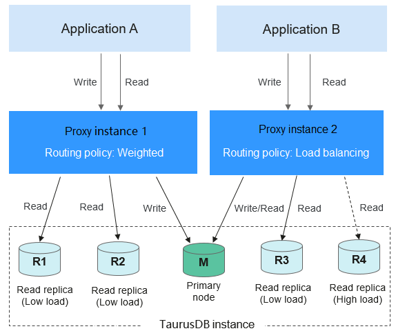

To isolate workloads from one another, you can create up to four proxy instances for a TaurusDB instance. Different applications can connect to different proxy instances as required. The associated read replicas of the proxy instances process read requests from different applications for workload isolation.
Figure 2 Read/write splitting with multiple proxy instances
