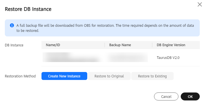

  3. On the Backups page, locate the backup you want to restore and click Restore in the Operation column.
  4. Set Restoration Method to Create New Instance and click OK.
    Figure 1 Restoring to a new DB instance

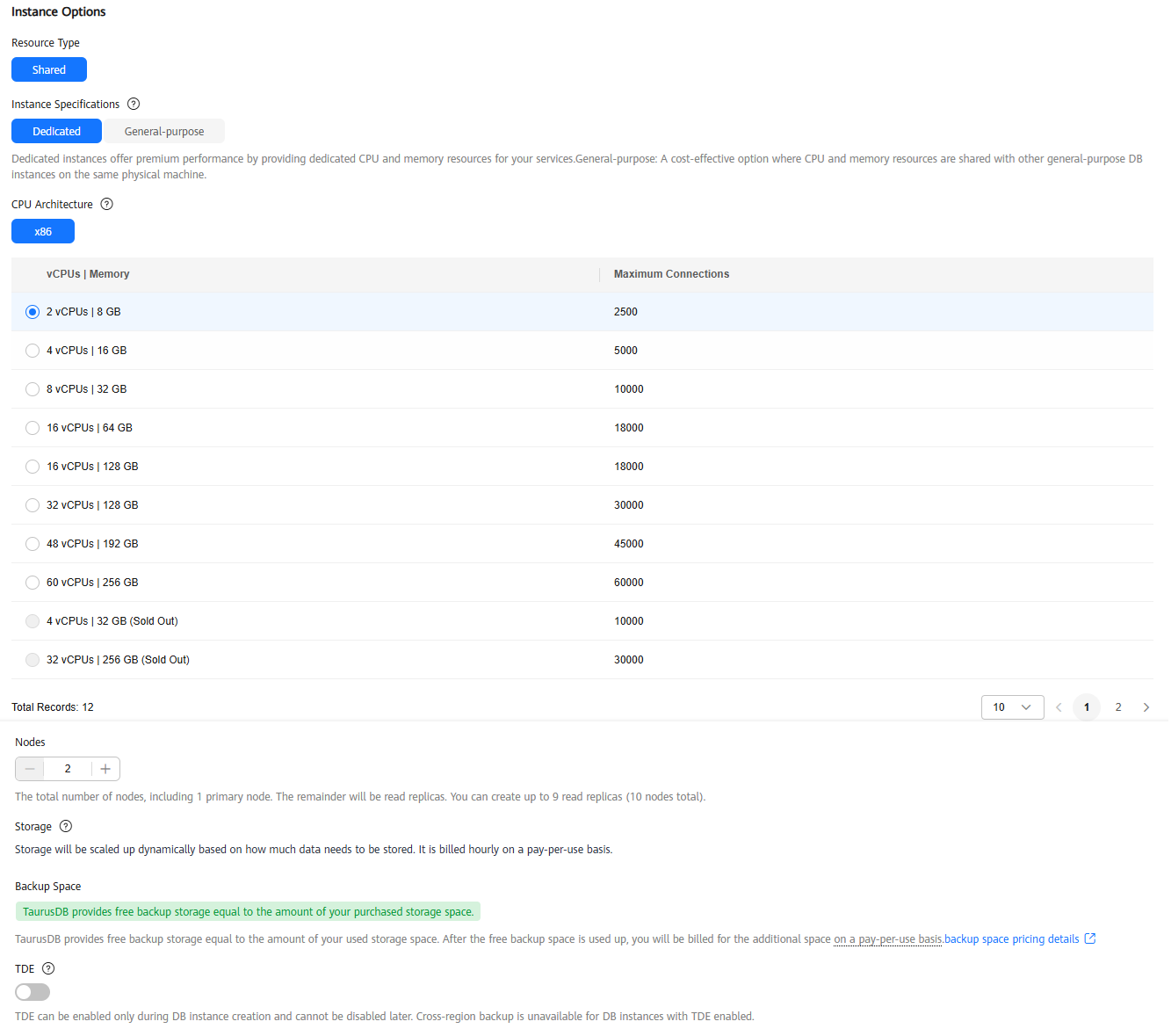

    • Instance options
      Figure 3 Specifications and storage
      Table 2 Specifications and storage
      Parameter
      Description
      Resource Type
      Select Shared.
      Instance Specifications
      TaurusDB is a cloud-native database that uses shared storage. To ensure that instances run stably under high read/write pressure, TaurusDB controls the read/write peaks of instances based on instance specifications. For details about how to select instance specifications, see Performance White Paper.
      For more information about instance specifications, see Instance Specifications.
      After an instance is created, you can change its vCPUs and memory.
      CPU Architecture
      Select x86 or Kunpeng.
      • x86: x86 instances use Intel® Xeon® Scalable processors and feature robust and stable computing performance. When working on high-performance networks, the instances provide the additional performance and stability that enterprise-class applications demand.
      • Kunpeng: Kunpeng instances use Kunpeng 920 processors and 25GE high-speed intelligent NICs for powerful compute and high-performance networks, making them an excellent choice for enterprises needing cost-effective, secure, and reliable cloud services.
      Nodes
      This parameter is mandatory for cluster instances.
      • By default, each instance can contain one primary node and multiple read replicas.
      • You can create up to 9 read replicas for a pay-per-use instance at once.
      • You can also add read replicas after an instance is created. Each instance can contain up to 15 read replicas. For details, see Adding Read Replicas to a DB Instance.
      Storage
      It contains the file system overhead required for inodes, reserved blocks, and database operations.
      Storage of a pay-per-use instance will be scaled up dynamically based on the amount of data that needs to be stored, and is billed hourly on a pay-per-use basis.
      Backup Space
      TaurusDB provides free backup space equal to the amount of your used storage. After the free backup space is used up, you will be billed for the additional space on a pay-per-use basis.
      DR Instance
      If your instance is unavailable due to unknown community bugs, misoperations, or AZ faults, a DR instance can take over the services.
      Only single-node RDS for MySQL DR instances are supported. DR instances are enabled by default when you buy a TaurusDB instance.
      Enabling this parameter automatically creates a DR instance and adjusts the binlog settings when your TaurusDB instance is ready.
      DR instances cannot be enabled for single-node or multi-primary TaurusDB instances.

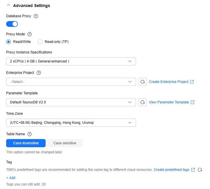

    • Advanced settings
      Figure 6 Advanced settings
      Table 5 Advanced settings
      Parameter
      Description
      Database Proxy
      Enabled by default. After a proxy instance is created, you can use the proxy address to connect to your DB instance.
      Proxy Mode
      You can select Read/Write or Read-only (TP) as needed.
      • Read/Write: All write requests are forwarded only to the primary node, and all read requests are forwarded to the selected nodes based on the read weights.
      • Read-only (TP): The primary node does not process write or read requests, and all read requests are forwarded to the selected read replicas based on read weights.
      Proxy Instance Specifications
      You can select the proxy instance specifications as needed.
      Enterprise Project
      This parameter is only available for enterprise users. To use it, contact customer service.
      An enterprise project provides a way to manage cloud resources and enterprise members on a project-by-project basis.
      You can select an enterprise project from the drop-down list. The default project is default.
      Parameter Template
      Contains engine configuration values that can be applied to one or more instances.
      In the drop-down list, you can select the original instance parameter template, the default parameter template (Default-TaurusDB V2.0), the high-performance parameter template (Default-TaurusDB V2.0-High Performance), or a custom parameter template in the current region as required.
      • If you select the original instance parameter template, parameters of the original instance are automatically synchronized. If the original instance is deleted, its parameters cannot be synchronized using backups.
        When you synchronize parameters of the original instance, the following parameters cannot be synchronized and you need to manually modify them after the instance is restored.
        innodb_write_io_threads, innodb_read_io_threads, max_connections, innodb_log_buffer_size, innodb_parallel_read_threads, temptable_max_ram, threadpool_size, innodb_buffer_pool_size, and innodb_page_cleaners
      • Default-TaurusDB V2.0 contains DB engine defaults and system defaults that are configured based on the engine, compute class, and allocated storage space of an instance. Parameter values in the default template cannot be changed, but you can create a custom template with whatever values you require.
      • Default-TaurusDB V2.0-High Performance is a set of optimized configuration parameters that aim to enhance the performance and reliability of database servers. The parameter settings in the template can be adjusted based on different application scenarios and hardware configurations. For details, see Introducing the High-Performance Parameter Template.
      • You can select a custom parameter template and change the parameter values as required. The changes to parameter values in a custom parameter template are not applied to your instance until you apply the template to the instance. For details, see Applying a Parameter Template. If you select a custom parameter template when creating an instance, the specification-related parameters in the custom template will not be applied. Instead, the default values are used. For details, see What Parameters Should I Pay Attention to When Creating a DB Instance?
      Time Zone
      You need to select a time zone for your instance based on the region hosting your instance. The time zone is selected during instance creation and cannot be changed after the instance is created.
      Tag
      Tags a TaurusDB instance. This parameter is optional. Adding tags helps you better identify and manage your instances. Each instance can have up to 20 tags.

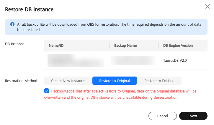

  4. Set Restoration Method to Restore to Original, select the confirmation check box, and click Next.
    Figure 7 Restoring to the original DB instance
  5. Confirm the task details and click OK.
    Data on the original DB instance will be overwritten and the original DB instance will be unavailable during the restoration.
