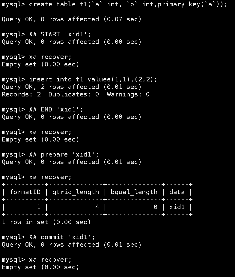

  • Before an upgrade, if there are any XA transactions in the prepared state, commit or roll back the transactions first. For details, see How Can I Check Whether There Are Any XA Transactions in the Prepared State Before an Upgrade?.

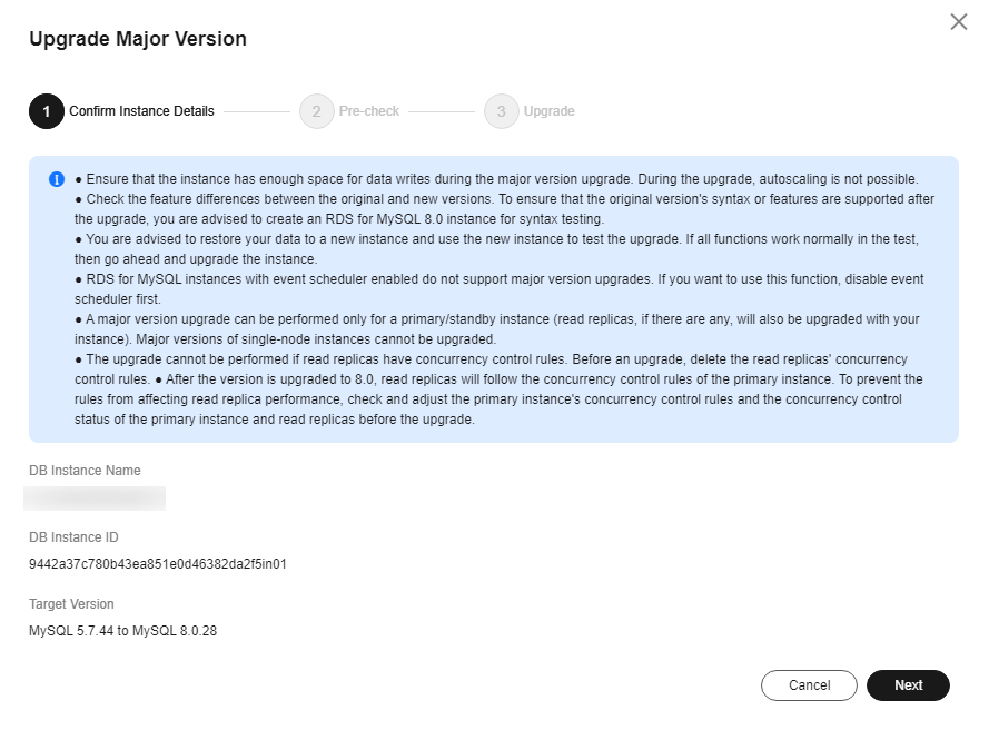

  1. Log in to the RDS console.
  2. Click in the upper left corner and select a region.
  3. On the Instances page, click the primary instance name.
  4. On the Summary page, click Upgrade Engine Version next to DB Engine Version.
    Figure 1 Upgrading a major version
  5. In the displayed dialog box, confirm instance details and click Next.
    Figure 2 Confirming instance details
    • If the instance is to be upgraded from MySQL 5.7 to 8.0, go to 6.
    • In other scenarios, go to 7.

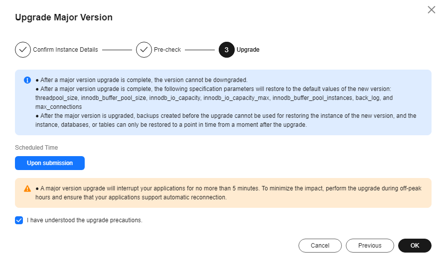

  7. Select a scheduled time and click OK.
    • Upon submission: The system upgrades your instance to the latest version of 5.7 or 8.0 immediately after you submit the upgrade request.
    • In maintenance window: The system will upgrade your instance to the latest version of 5.7 or 8.0 during the maintenance window you specified. For details, see Configuring the Maintenance Window.
    Figure 5 Selecting a scheduled time
    If the upgrade fails, rectify the fault by referring to Table 4.
