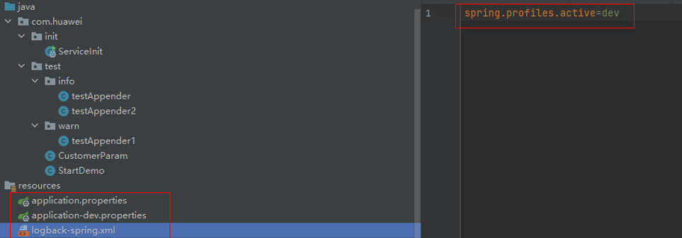

  • For a Spring Boot project, you can replace logback.xml with logback-spring.xml, the configuration in springProfile can be read, and the log collection environment between development and test environments can be seamlessly switched.
    Instructions:
    1. You can specify the configuration items used in application.properties of the Spring Boot project.
    2. Configurations in logback-spring.xml:
          <springProfile name="dev">
              <root level="INFO">
                  <appender-ref ref="customerAppender"/>
              </root>
          </springProfile>
