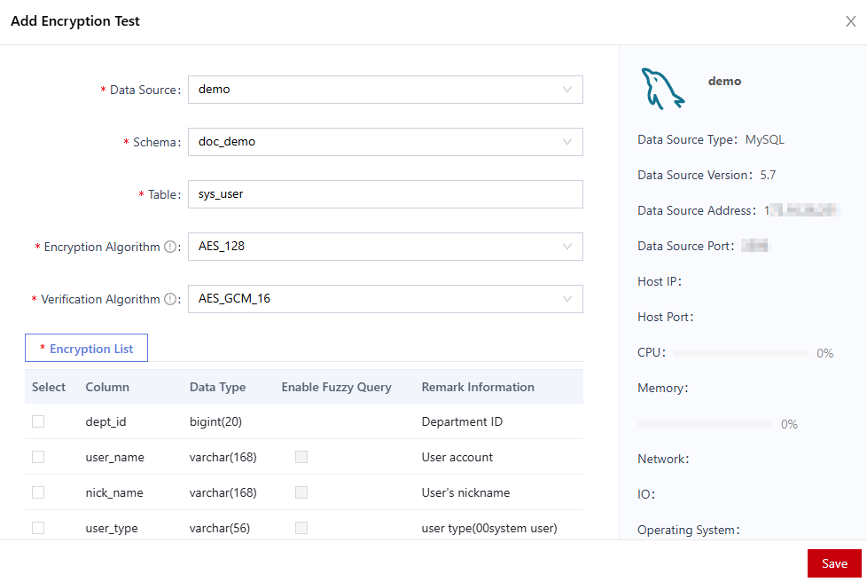

- In the displayed dialog box, configure the test target. For details about the related parameters, see Table 1.
Figure 1 Adding an encryption test
Table 1 Simulation test Parameter
Description
Data Source
Name of an asset.
Schema
Name of the schema of the asset.
Table
Table name of an asset.
Encryption Algorithm
Select an encryption algorithm from the drop-down list box.
You can view the supported algorithm types on the Checking the Encryption Algorithm page.
Verification Algorithm
Select a verification algorithm from the drop-down list.
The verification algorithm is used to verify the integrity of important data. You can view the supported algorithm types on the Checking the Encryption Algorithm page.
- Click the Encryption List tab and select the columns to be encrypted.
- Click Save.
