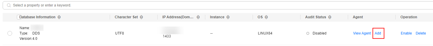

  5. In the Agent column of the desired database, click Add.
    Figure 5 Adding an agent

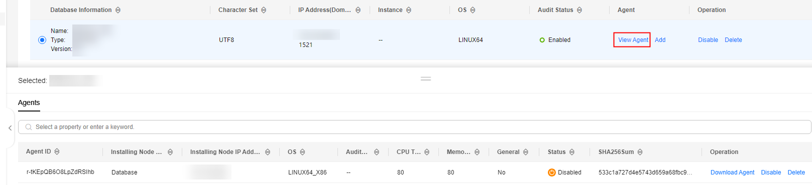

  8. In the Agent column of the desired database, click View Agent. In the Agents area, view information about the added agent.
    After adding the agent, confirm that the agent information is correct. If the agent is incorrectly added, click Delete in the Operation column of the row to delete it, and add an agent again.
    Figure 7 Successfully adding an agent
    Figure 8 Adding an agent
    Figure 11 Successfully adding an agent
