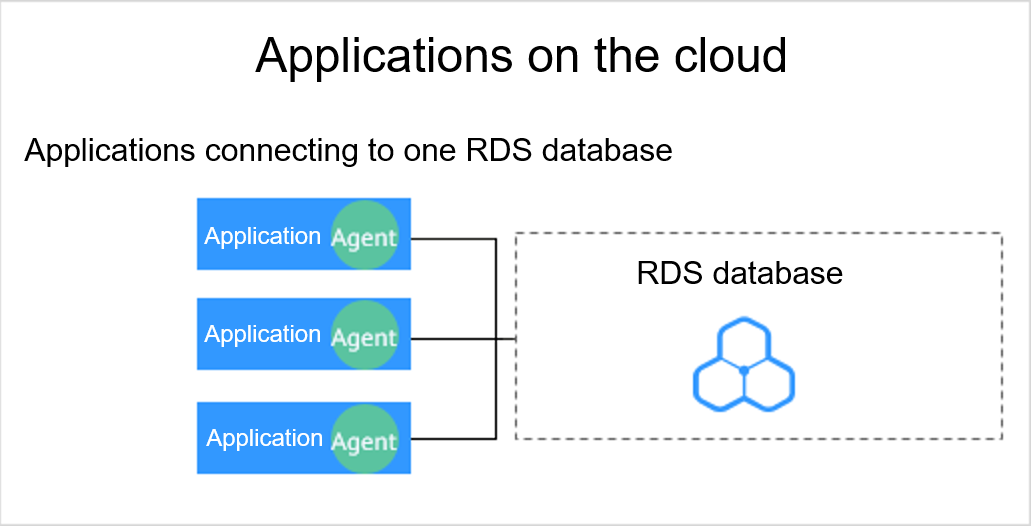

If multiple applications (ECSs) are connected to the RDS you want to audit, you need to deploy the agent on all the ECSs. See Figure 1.
Figure 1 Multiple applications connecting to one RDS database
