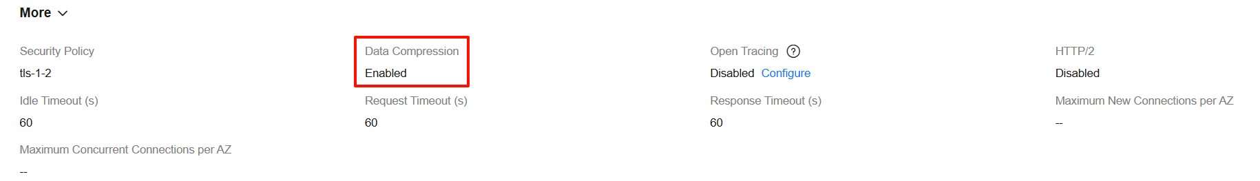

Verifying Configuration
  1. Log in to the CCE console and click the cluster name to access the cluster console.
  2. In the navigation pane, choose Services & Ingresses. Locate the row that contains the created Service and click the load balancer name to go to the ELB console.
  3. Switch to the Listeners tab, click the listener name of the created port, and check whether the option is enabled.
