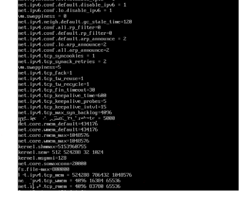

 - Check whether the kernel parameter settings are the same. The result shows that the network parameters on the ECS where the backup job failed are not optimized.
 - Set the kernel parameters of the ECS where the backup job failed to the same as those of the ECS where the backup job succeeded. Start a backup job again. The backup job is successful.
