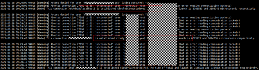

  1. View error logs of the instance to check whether the information "connection xxx is established slowly" is displayed. Example:
    If yes, some connections have timed out and have not been processed by the RDS for MySQL instance yet. When the connection between a client and the instance exceeds the specified timeout duration, an error is reported.

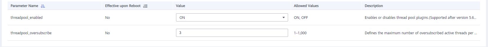

  2. Check the thread pool configuration (enabled by default) on the console.
    In the preceding figure, threadpool_oversubscribe is set to 3. The wait time for the thread pool to process connections is related to this parameter.
