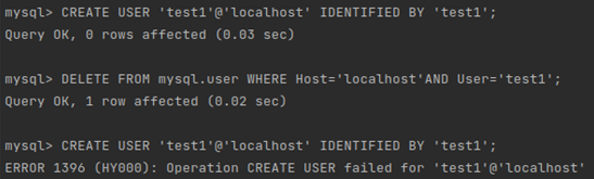

Troubleshooting example:

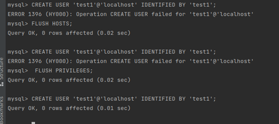

After an account is created, the delete statement is used to delete the account. When a new account with the same name as the deleted account is created, error 1396 is reported. After the flush privileges command is executed, an account with the same name can be created.
Solution
  • Method 1 (recommended): During off-peak hours, run the drop user user_name command as the administrator to delete the disappeared account and then create an account with the same name.
  • Method 2: During off-peak hours, run the flush privileges command as the administrator and then create an account with the same name. You are advised to enable SQL Audit to locate which client deletes the user.
