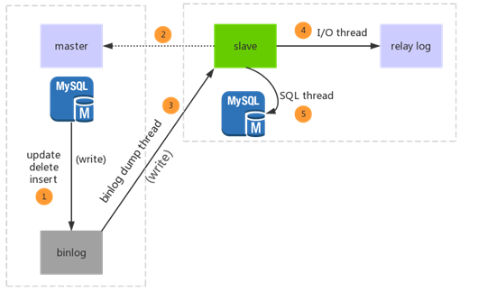

Primary/Standby Replication Process
  • When data is updated on the master node, the update is written to the binlog of the master node as an event. The event types include INSERT, DELETE, UPDATE, and QUERY.
  • When slave nodes are connected to the master node, a binlog dump thread is created for each slave node.
  • When the binlog of the master node changes, the binlog dump threads notify all the slave nodes of the change and push the binlog updates to the slave nodes.
  • After receiving the binlog updates, the I/O thread of each slave node writes the updates to the local relay log.
  • The SQL thread of each slave node reads the relay log and replays the operation (such as DML and DDL) based on the event in the relay log.
