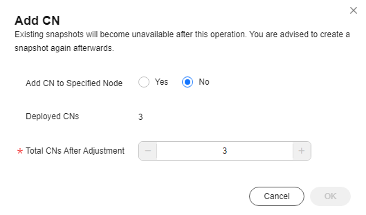

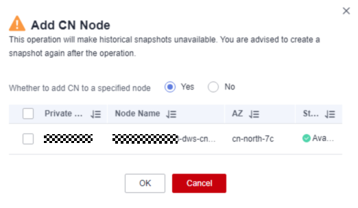

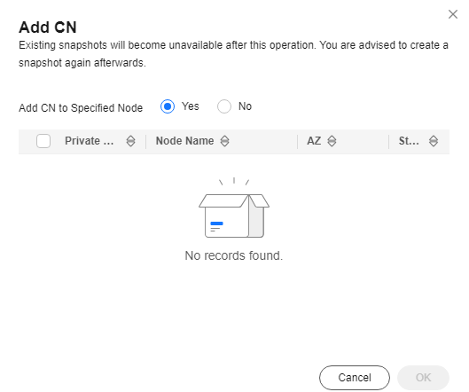

  4. On the displayed page, determine whether to add a CN to a specified node. You cannot add more CNs than the number of CNs that have already been deployed.
    • If you select No, you can set Total CNs After Adjustment. The value cannot exceed the number of nodes.
      • Terminate Blocked Job:If you enable this function, you can configure automatic job termination.
      • Time Before Blocked Job Termination (s): If job termination is enabled and congestion occurs during online CN adding, the system waits for the duration you specified and then terminates congested jobs. The value can be an integer in the range 30 to 1200.
      Figure 1 Adding CNs
    • If you select Yes, specify the node.
  5. Click OK.

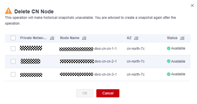

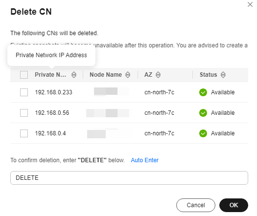

  4. On the displayed page, select the CN node to be deleted. After confirming that the information is correct, enter DELETE or click Auto Enter and click OK.
    • At least two CNs must be retained.
    • When deleting a CN from a multi-AZ cluster, reserve a normal CN in each AZ. Faulty CNs (if any) can be deleted.
    • Yoyu can delete a CN only if the cluster is in the Available, Degraded, or Unbalanced state.
    • A CN with an EIP cannot be deleted.
    • If there are abnormal CNs, only such CNs can be deleted.
      • If one CN is faulty, only this CN can be deleted.
      • If two or more CNs are faulty, no CN can be deleted.
