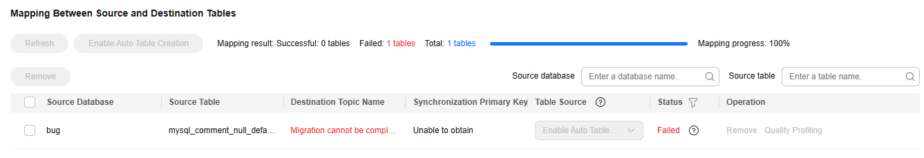

- Update the mapping between the source table and destination table and check whether the mapping is correct. You can change the names of mapped destination topics as needed. You can map one source topic to one destination topic or map multiple source topics to one destination topic.Figure 7 Mapping between source and destination tables

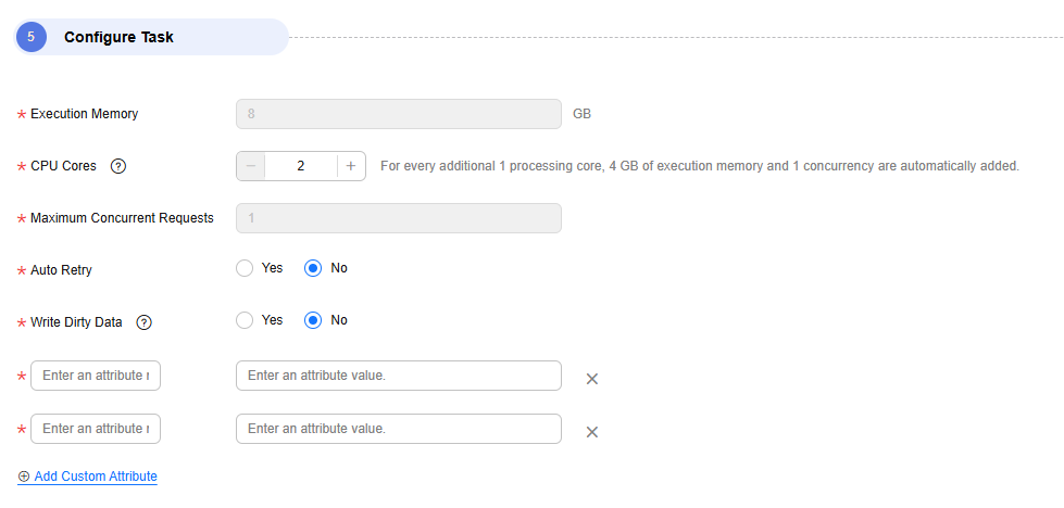

- Configure task parameters.
Table 7 Task parameters Parameter
Description
Default Value
Execution Memory
Memory allocated for job execution, which automatically changes with the number of CPU cores
8GB
CPU Cores
Value range: 2 to 32
For each CPU core added, 4 GB execution memory and one concurrency are automatically added.
2
Maximum Concurrent Requests
Maximum number of jobs that can be concurrently executed. This parameter does not need to be configured and automatically changes with the number of CPU cores.
Auto Retry
Whether to enable automatic retry upon a job failure
No
Maximum Retries
This parameter is displayed when Auto Retry is set to Yes.
Retry Interval (Seconds)
120s
Add Custom Attribute
You can add custom attributes to modify some job parameters and enable some advanced functions. For details, see Job Performance Optimization.
N/A
