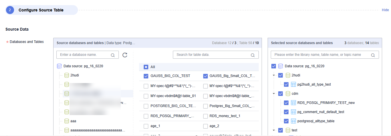

  6. Configure source parameters.
    Select the databases and tables to be synchronized based on the following table.
    Table 5 Selecting the databases and tables to be synchronized
    Synchronization Scenario
    Configuration Method
    Entire DB
    Select the GaussDB databases and tables to be migrated.
    Figure 4 Selecting databases and tables
    Both databases and tables can be customized. You can select one database and one table, or multiple databases and tables.

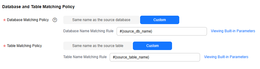

  7. Configure destination parameters.
    • Set Database and Table Matching Policy.
      For details about the matching policy between source and destination databases and tables in each synchronization scenario, see the following table.
      Table 6 Database and table matching policy
      Entire DB
      • Database Matching Policy
        • Same name as the source database: Data will be synchronized to the Hudi database with the same name as the source GaussDB database.
        • Custom: Data will be synchronized to the Hudi database you specify.
      • Table Matching Policy
        • Same name as the source table: Data will be synchronized to the Hudi table with the same name as the source GaussDB table.
        • Custom: Data will be synchronized to the Hudi table you specify.
          Figure 5 Database and table matching policy in the entire database migration scenario
          NOTE:
          When you customize a matching policy, you can use built-in variables #{source_db_name} and #{source_table_name} to identify the source database name and table name. The table matching policy must contain #{source_table_name}.

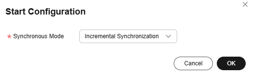

    After submitting the job, click Start on the job development page. In the displayed dialog box, set required parameters and click OK.
    Figure 11 Start Synchronization Job
    Table 11 Parameters for starting a synchronization job
    Parameter
    Description
    Synchronization Mode
    • Incremental: Incremental data synchronization starts from a specified time point.
    • Full and incremental synchronization: All data is synchronized first, and then incremental data is synchronized in real time.
    • From the last save time: Data synchronization will start from the time when the last synchronization stopped or was automatically saved.
