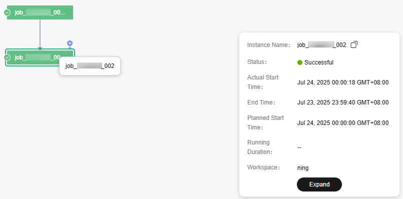

    • Click a job instance to select it.
      Figure 8 Selecting a job instance
      • When you select a node, the job instance name is displayed.
      • Brief information about the instance is displayed in the lower right corner of the DAG. The instance name can be directly copied.
      • Click Show Details to open the details panel, which displays information such as the instance attributes, job parameters, node list, and historical instances. You can adjust the height of the panel or close it.
      • Click the blank area to deselect the job instance.

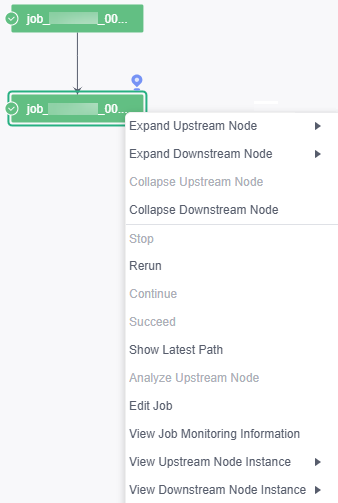

    • Right-click a job instance to expand its upstream and downstream job instances. You can stop, rerun, continue to execute instances, forcibly make instances succeed, analyze the upstream node, and edit the job. You can view a maximum of five layers of upstream and downstream node instances. You can expand and collapse upstream and downstream nodes.
      Right-click a job instance and select Rerun to set the parameters for reruning the job instance. For details, see Rerunning Job Instances.
      Figure 9 Performing operations on job instances

  1. In the left navigation pane on the DataArts Factory console, choose Monitoring > Monitor Instance.
  2. Locate a job and click DAG in the Operation column. On the displayed Dependencies page, select List View.
    Figure 10 List View
  3. View details of the current job instance. In the Operation column, you can click Edit to edit the job and click View Job Monitoring to view monitoring information of the job.
  4. View the upstream and downstream instances on which the current job instance depends. When viewing upstream and downstream instances, you can click Back to Initial Instance to return to the current instance.
