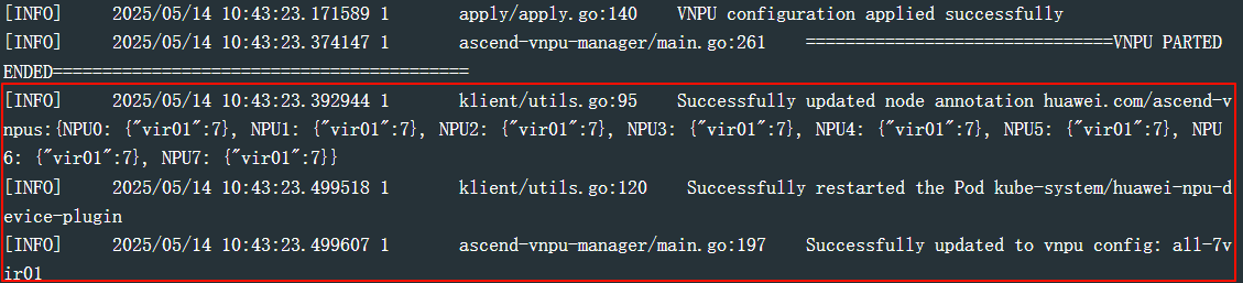

  5. After static NPU virtualization is configured, verify it by viewing ascend-vnpu-manager logs.
    In the navigation pane, choose Add-ons. On the right of the page, find the CCE AI Suite (Ascend NPU) add-on and click View Details. Switch to the Pods tab and find the ascend-vnpu-manager pod of the target node. In the Operation column, choose More > View Log.
    • NPU virtualization configuration is successful if the following information is displayed in the logs.
      Figure 1 Verifying NPU virtualization
    • If logs display messages like "Error: error applying VNPU configuration: failed to apply func on device1, err: NPU1 has VNPU in use ...", NPU or vNPU workloads are running on the node, preventing NPU virtualization configuration. To resolve this issue, do as follows:
      Delete the NPU or vNPU workloads on the node, and then delete the ascend-vnpu-manager pod. NPU virtualization will function correctly on the node after the pod is restarted and runs properly.
