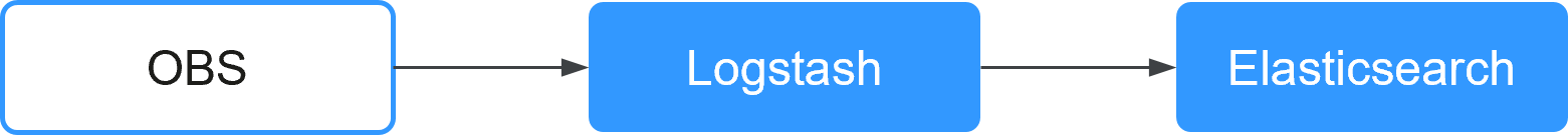

Solution Architecture
Figure 1 Solution architecture
Logstash can ingest data from a variety of data sources. For data stored in OBS, you can use Logstash's logstash-input-s3 plugin to read objects from OBS and then use the logstash-output-elasticsearch plugin to synchronize the processed data to the destination Elasticsearch cluster.
  1. Input: The logstash-input-s3 plugin connects to an OBS bucket, monitors specified files, and read their data.
  2. Processing: Filters can be configured in the Logstash configuration file to clean, transform, and structure the data (for example, use the Grok filter to parse log formats).
  3. Output: The logstash-output-elasticsearch plugin connects to the destination Elasticsearch cluster and indexes the data.
