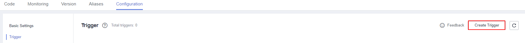

  3. Choose Configuration > Triggers and click Create Trigger.
    Figure 1 Creating a trigger
